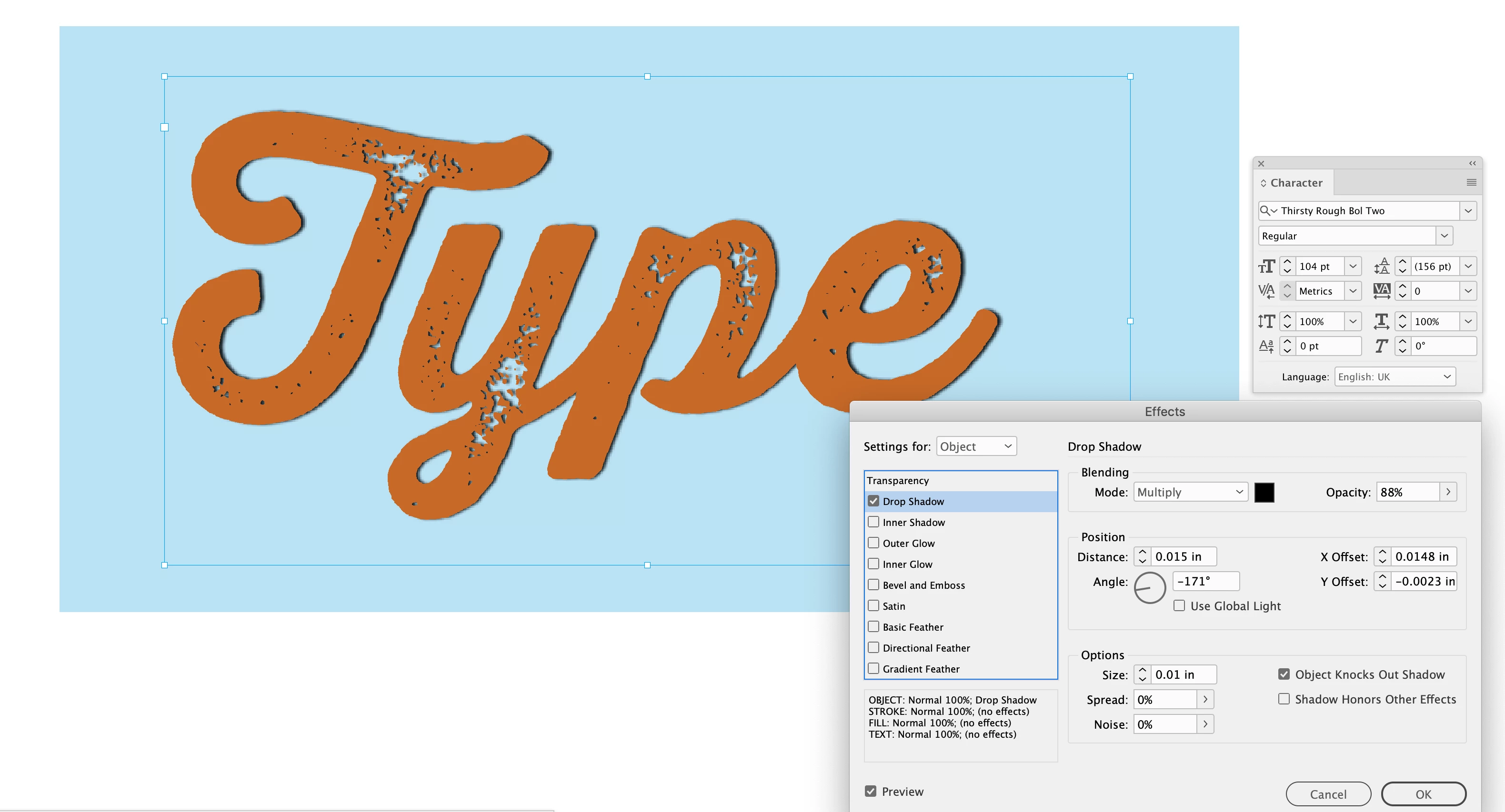

June 17, 2023
Hi @Katherine25238449muqx , Your screen capture looks like a simple drop shadow. Here I’m using Adobe Fonts’ Thirsty Rough Bol Two:
June 22, 2023
Thank you!  Ah yes (Thirsty Rough Bol Two is great too!), but you can only see the blue in the type.  I'd like to see another color like white specs as well, see.  🙂
