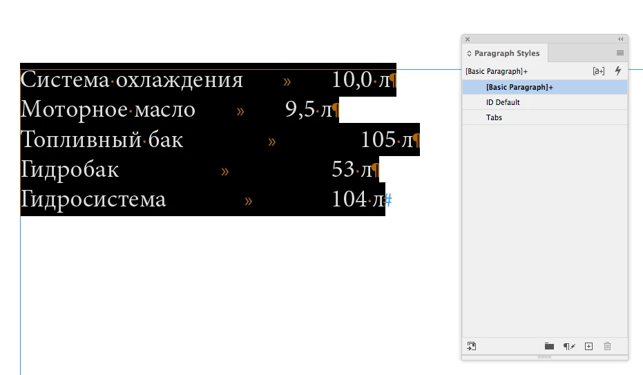

Hi, I have below text frame is there any script to adjust tab between text and Values. Tab length values would be readjusted in script.
Система охлаждения                            10,0 л
Моторное масло                           9,5 л
Топливный бак                                            105 л
Гидробак                                           53 л
Гидросистема                                             104 л
Result should be as below:
Топливный бак                                      105 л
Гидробак                                                53 л
Гидросистема                                        104 л

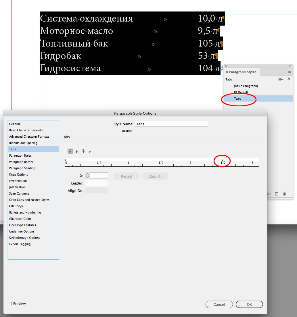

I’m not sure you need a script, you can make a Paragraph Style that contains to correct tab stop. Something like this:
With all the text selected apply the style:
