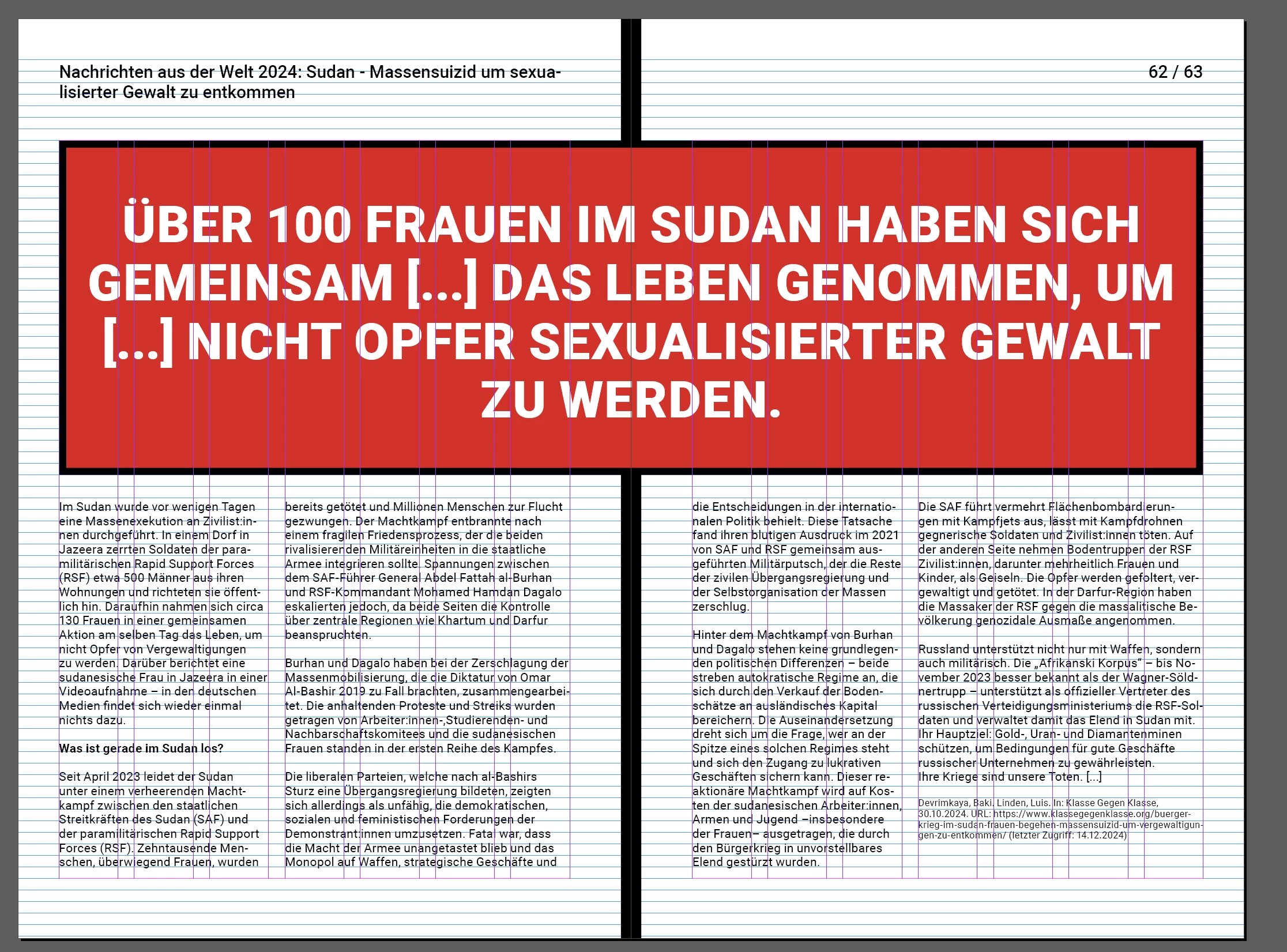

I have created an InDesign layout where text is used as a design element, with large typography spanning across the full double-page spread. Now, I need to add gutter space (inside margin) after the fact. What is the easiest way to do this without completely reworking the layout?
I added 2 screenshots for better understanding. The black lines in the background on the inner side mark the gutter space.

I'd suggest just adding a 5mm inside bleed to the existing layout.

How it will be printed and then finished?
Because there might be nothing to do for you - it can be "resolved" during imposition.

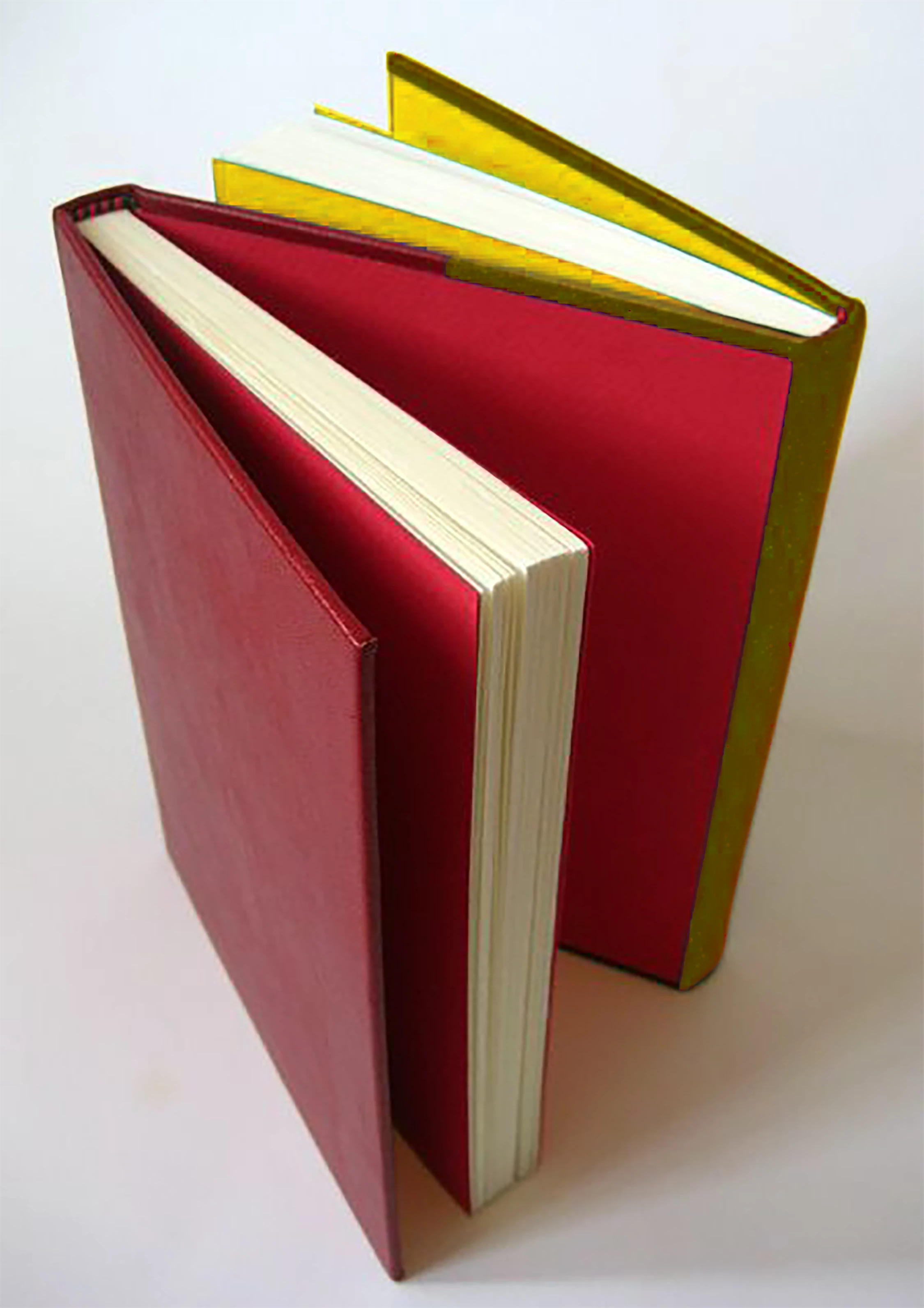

I will send it to print. They need 5mm gutter space and it will be cold glued. I think. After that i will do a double-book-binding by myself.
But if you have any idea of binding which would work better with that i would be happy to adjust.

OK. if it will be cold glued - then you don't have too many options - it will always look bad...
How many total pages will you have?
