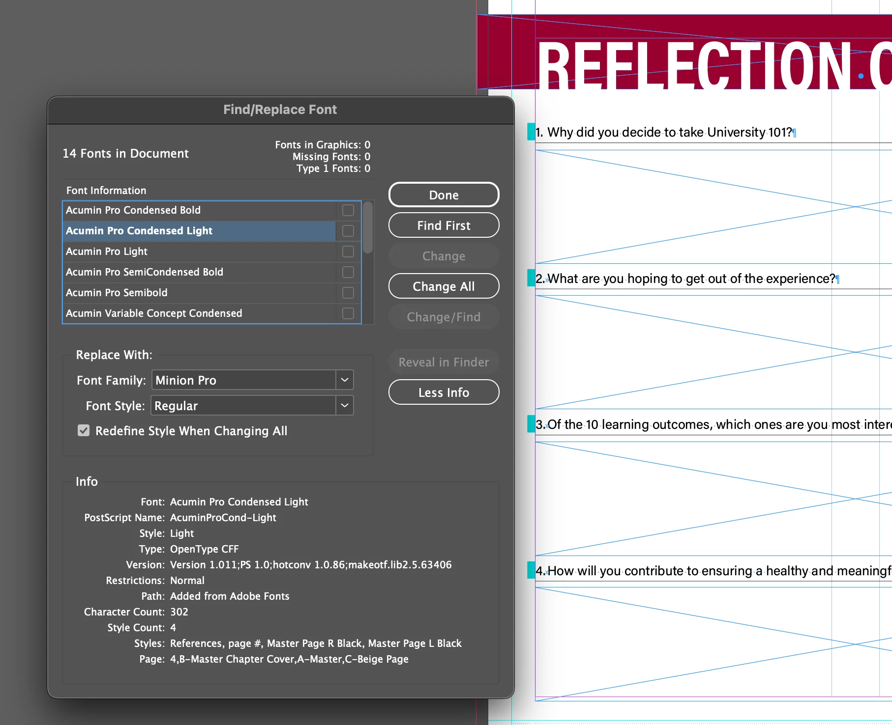

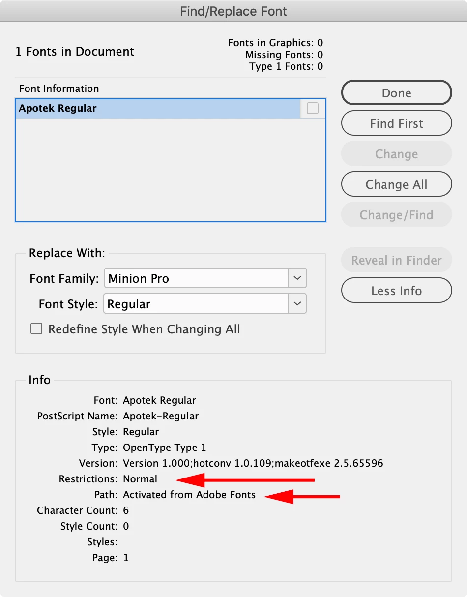

    Hi @ErinEvergreen , The name of the font would help.
    Adobe Fonts have Normal Restrictions—they get embedded in a PDF:
    ErinEvergreen
    Jul 1, 2025 7:35 PM UTC

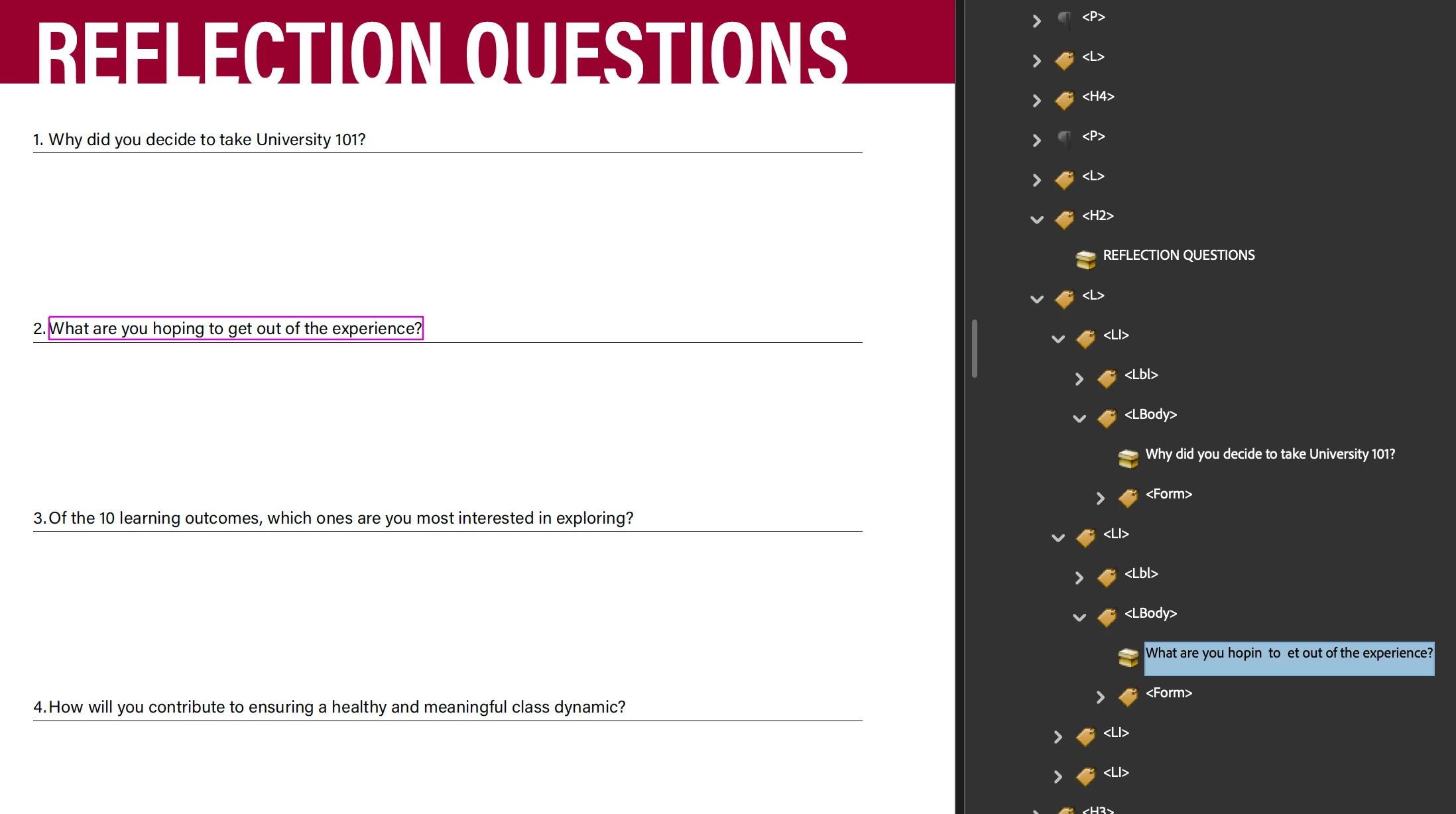

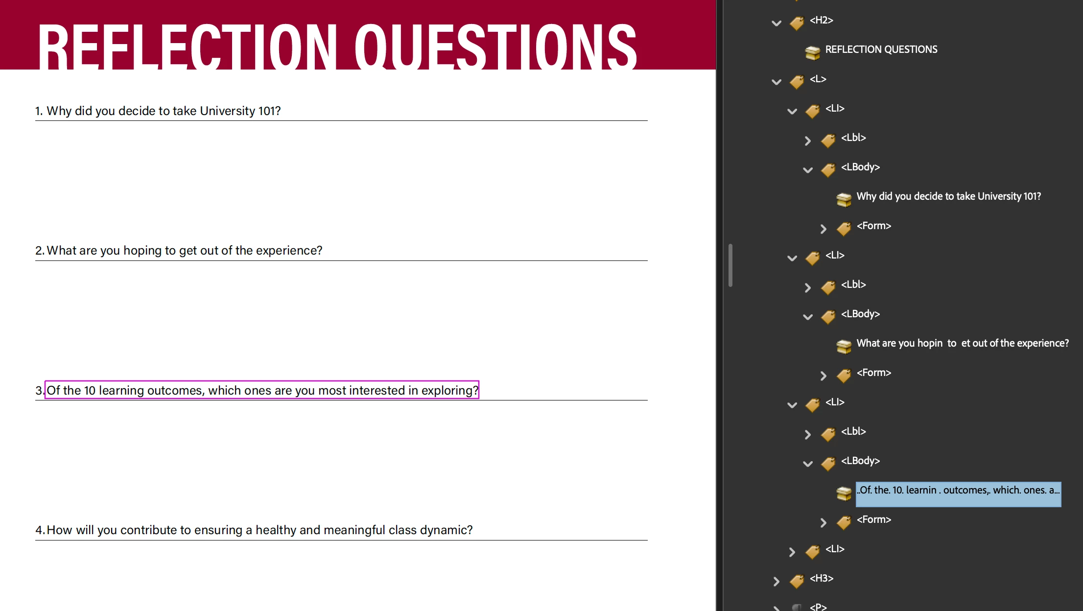

    Does "normal" mean not usable in an interactive accessible PDF? They render fine in InDesign, print PDFs, interactive PDFs - it is just when we make it accessible using Acrobat's functions that they corrupt. Acumin Pro Condensed plus every other Adobe font (tested many).

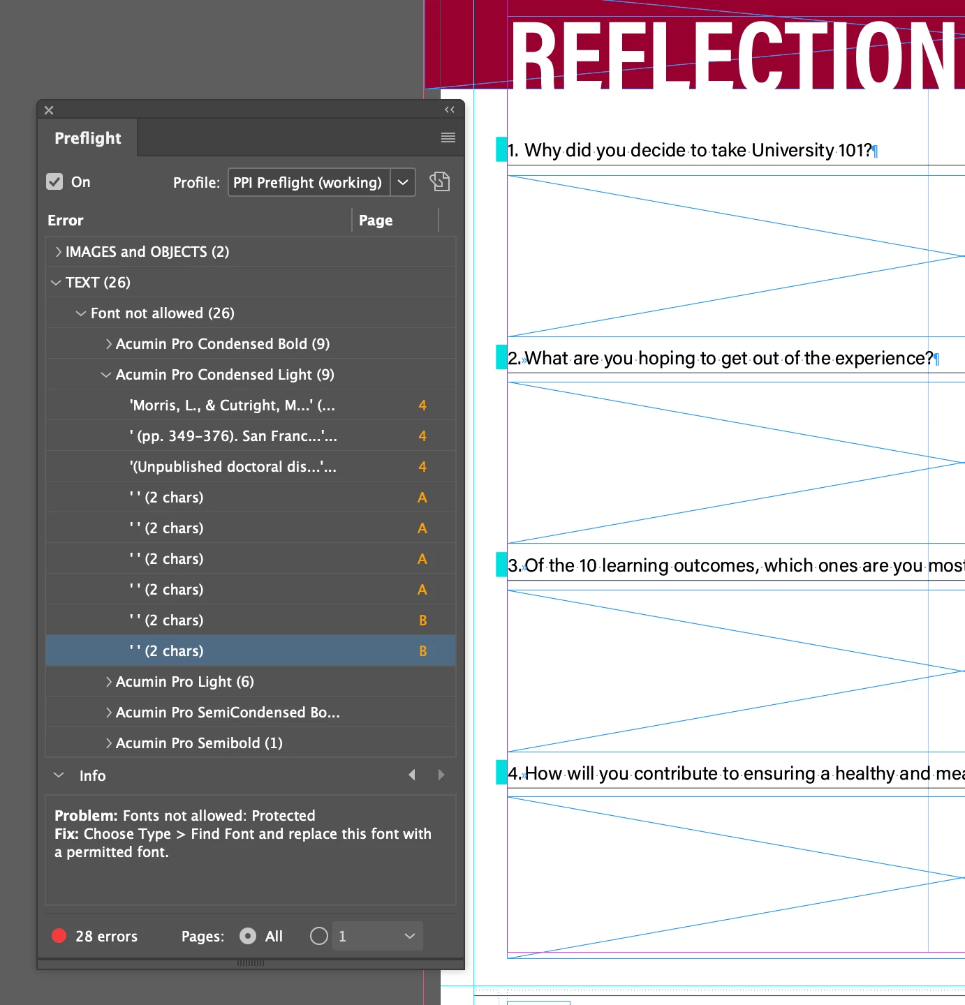

    Name of the font - every single Adobe font is an issue. We'll use Acumin Pro Condensed Light as an example. I've got some screenshots to better help explain / demo the issue:
    1. Screenshot of InDesign document with the FInd Font window open (all looks OK!)
    2. Screenshot of the preflight that shows an issue with the font being protected. Note - every single Adobe font comes up as protected and a preflight error. I don't know if this is just to warn to embed or nto edit a PDF, but maybe a clue.
    3. and 4. Screenshots of the tagged PDF showing the font not reading correctly in the accessible tag. (I've tried every variation of making the PDF - fonts are definitely embedded. Note these are intereactive PDFs, so this is where my general question comes in about the use of Adobe fonts in accessible PDFs. At this point I'm wondering if it is a bug because surely they didn't mean to restrict access for this particular usage?)
