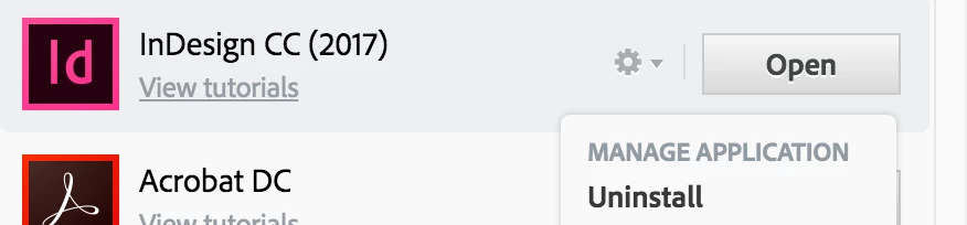

    Did you uninstall InDesign from the  drop-down menu in Creative Cloud app (see screen shot below) and then run Adobe Cleaner before reinstalling InDesign Use the Creative Cloud Cleaner Tool to solve installation problems ?

    I have indeed tried uninstalling InDesign through Creative Cloud using the method you've shown, and I have also uninstalled all Creative Cloud programs and then run the Creative Cloud Cleaner Tool.  The tool was 'successful' according to the log, and I then reinstalled the various programs I need -- everything worked except for InDesign.  (The Creative Cloud app has been buggy, and sometimes won't launch correctly, but I've always had this problem with that app!)
