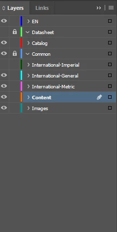

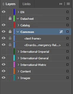

I have a problem modifying sublayers inside a locked layer;
If I expand the layer, I can't see any objects inside it.
The objects appear only if I select the layer shift+ctrl+click on it;
This is not letting the SDK return those items when I run Spread.GetItemsOnPage()
Any idea whats going on here?

So you mean to say that the locked layer if expanded shows blank under it and when you unlock it then you start seeing the pageitems? Can you post screenshots? This is not normal behaviour, normally you should see the pageitems on expanding the layer even if the layer is locked. Does this happen with every document you create?

Amine9Author
September 5, 2022
Even if I unlock it, pageItems are not shown in the layer panel, to make them appear, I have to unlock the layer and select it by using ctr + alt + click on the layer.
Before and After images attaches
September 5, 2022
Does this happen with every document you create? Can you share a demo document for me to test this out?
Also the after image you shared is it after your script ran on the document? If so then please share the code of the script for us to have a look at.
