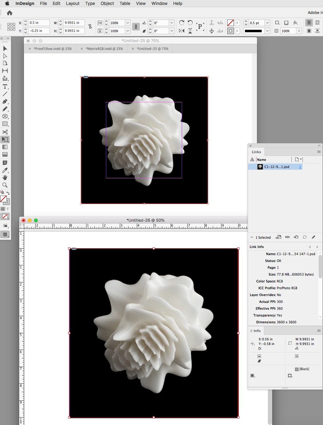

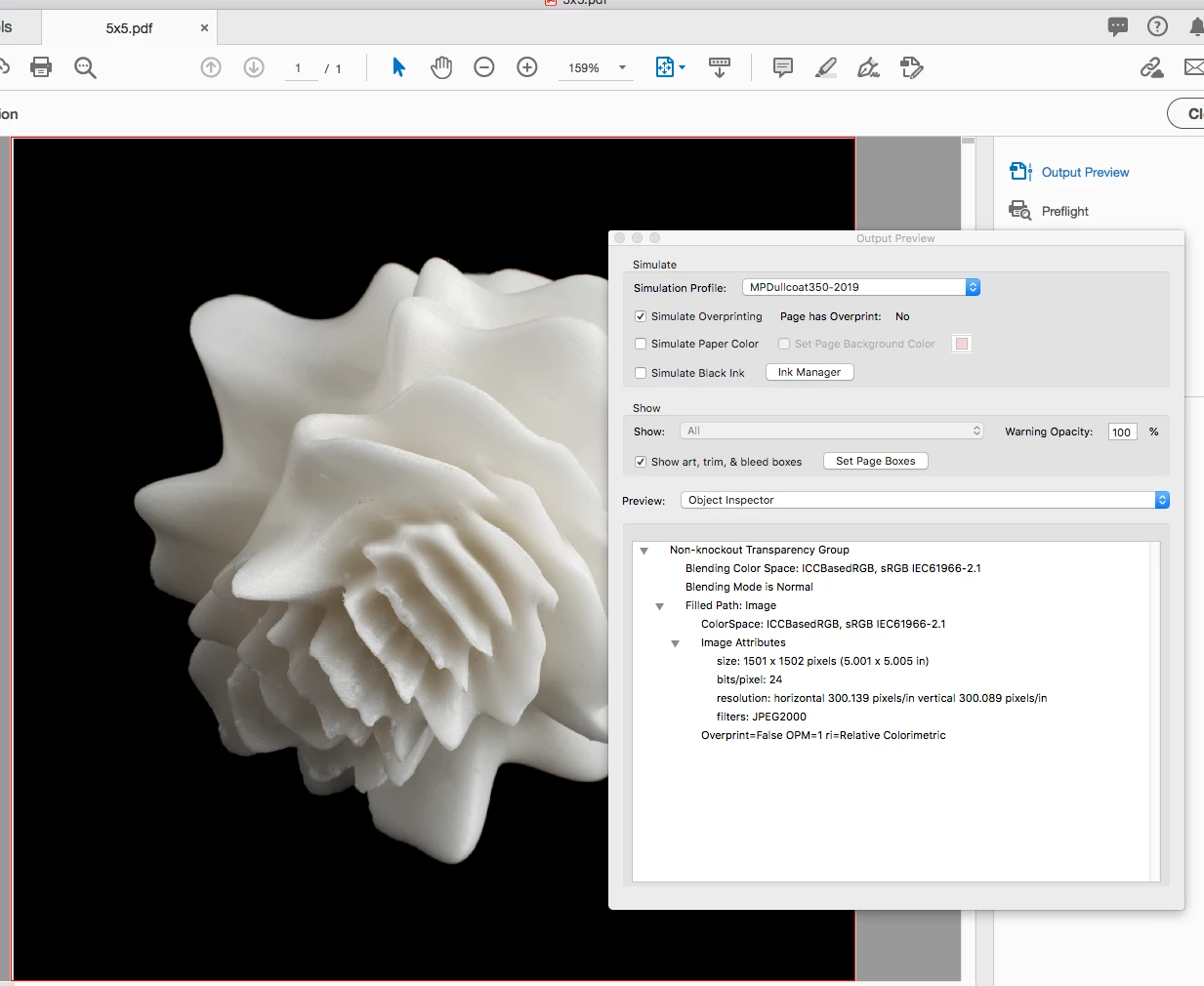

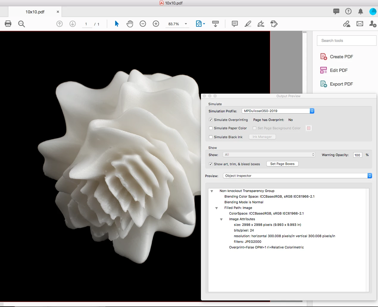

Dec 14, 2020 2:07 PM UTC
You could work with a larger page dimension and make sure the placed image’s Effective Resolution is equal to or higher than 300ppi. Here I have two documents, one at 5" x 5" and the other at 10" x 10". The image in both cases have an Effective res well over the 300ppi resolution I’m setting in the export.
If I check the pixel dimensions in AcrobatPro the 10x10 version is twice as large as the 5x5 version, even though both have been exported at 300ppi:
