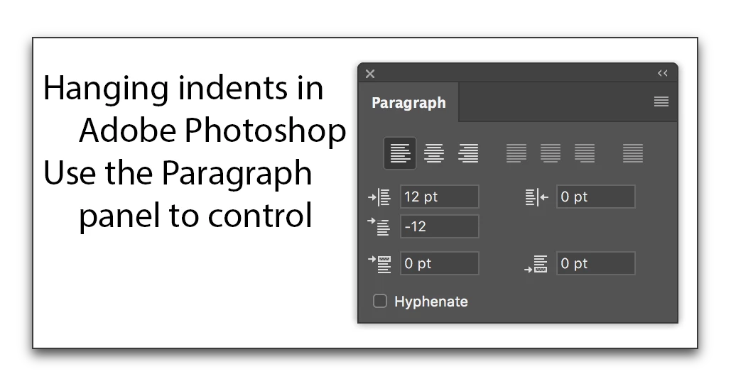

So your reason for incorporating InDesign into this workflow is:
I noticed lots of text needed justifying, hanging indentation etc which would be easier in InDesign.  So I thought about placing all the cards into ID with the layers and editing them there.
You can correct the alignment and indents in the Paragraph panel in Photoshop. If you decide you want to use InDesign, you will have to retype the text first. You won't be able to to edit the text in a Photoshop document in InDesign.
Barb Binder
Barb BinderCommunity ExpertCorrect answer
July 5, 2017
