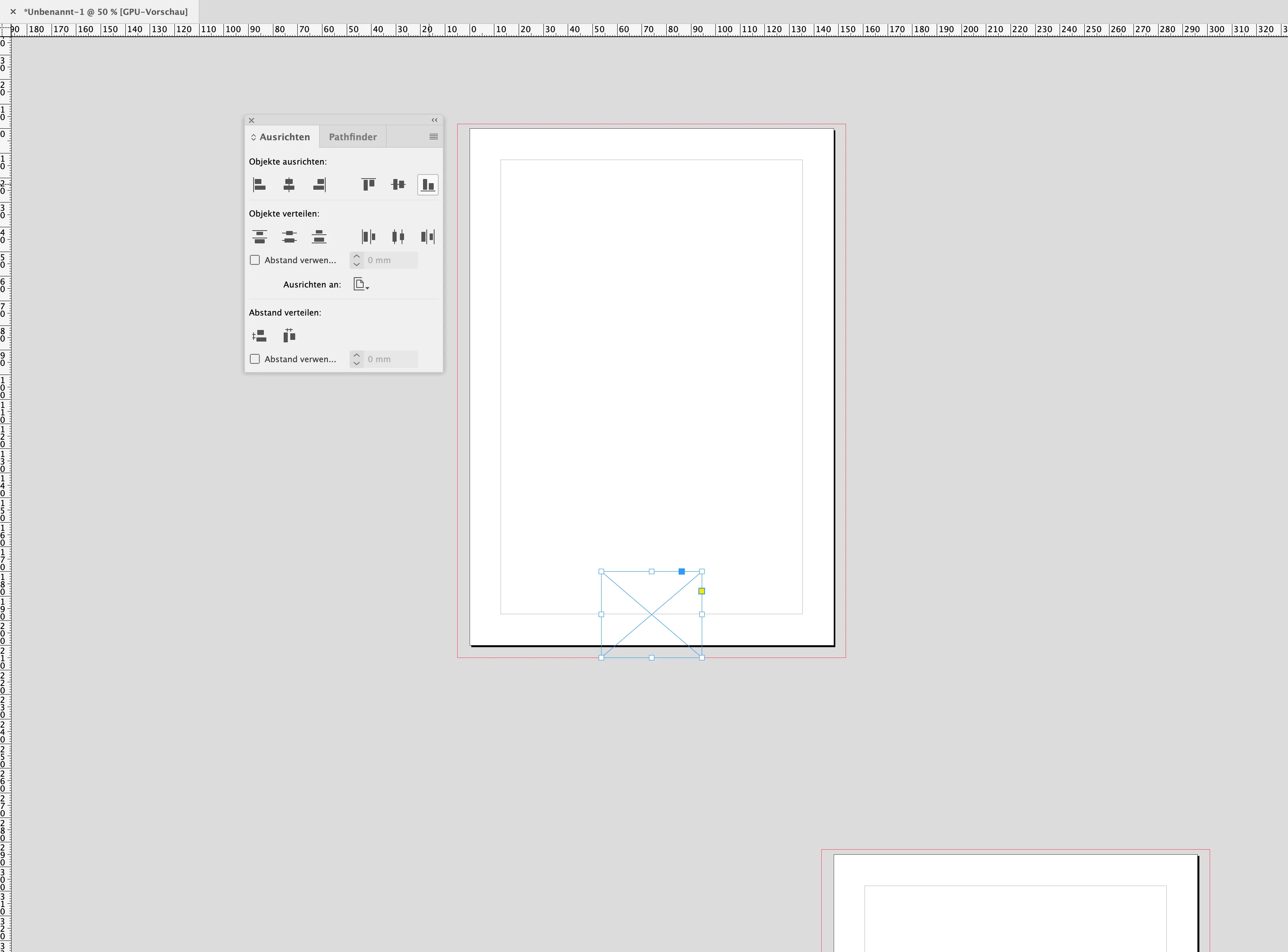

@Brad @ Roaring Mouse said: "… The Align to Bleed function works incorrectly for certain bleed situations."
Indeed. I can see this also with my German InDesign 2025 v20.5.0.
A different example: If you move a page of a facing pages document down with the Page tool so that the inner bleed will not touch the facing page you see strange things happen:
The object will not move according to the outer bleed value of 5 mm, but to the value of the inner bleed which is 2 mm in the case above when using Align Left. And then it will move not to the inner bleed, but to the outer bleed of the facing page when using Align Right:
Means: Inner bleed does not work at all (facing pages document).
Top Align and Bottom Align will work with different bleed settings. Align Top:
Align Bottom:
