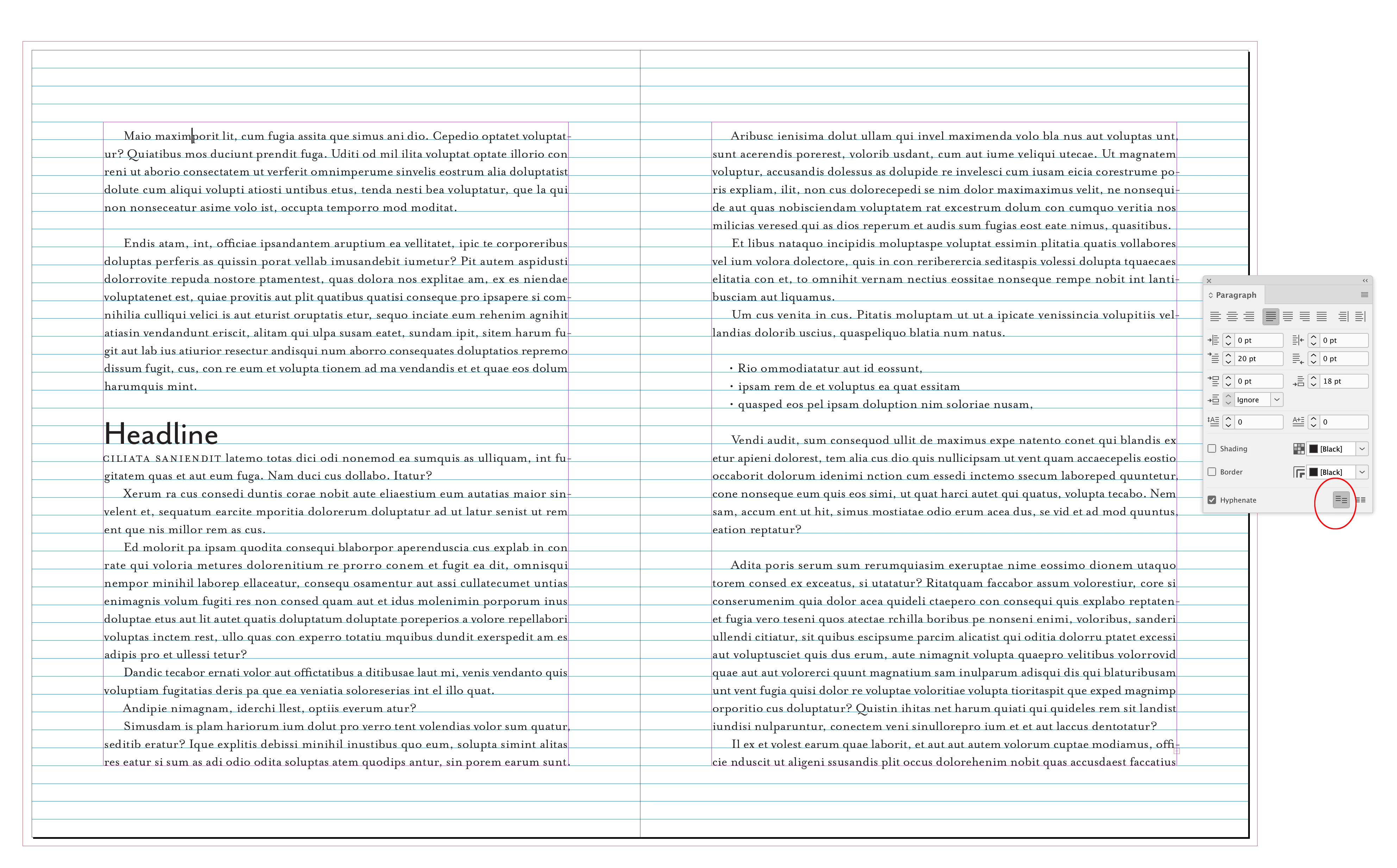

Setting the paragraphs to Align to baseline grid could solve the last line alignment problem, but when aligning to the baseline grid you have to watchout for other spacing problems caused by the enforced alignment.

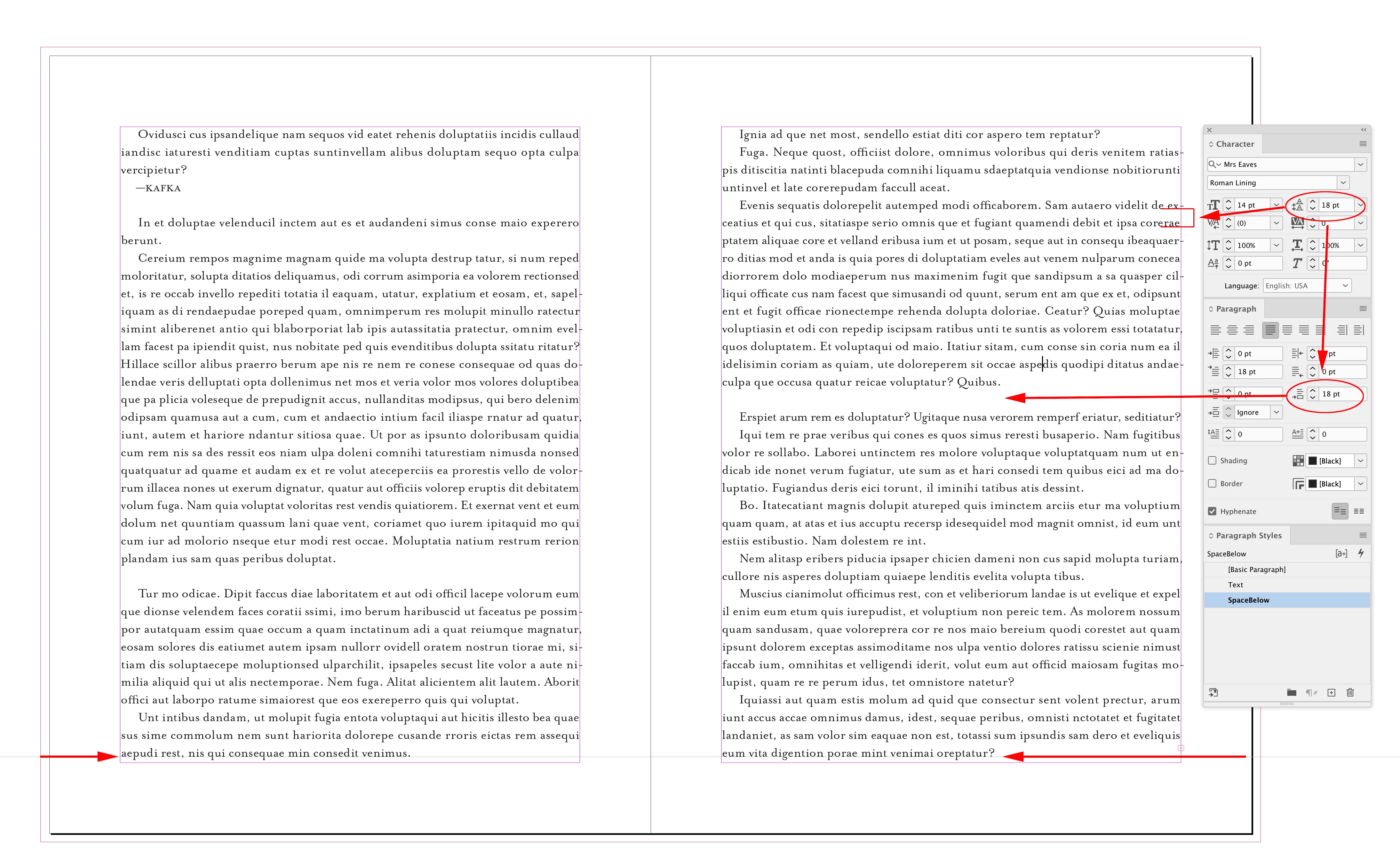

On this spread all the lines align across the spread because all of the paragraph’s leadings are set to the same 18pts, and the space before or after is either set to 0pt or 18pt—the lines align across the spread whether I turn on align to the grid or not:
If I randomly add a half point to some of the paragraph leadings and space below, the lines no longer exactly align:
But when I turn on Align to Baseline Grid for all the paragraphs this happens—the leading of the paragraph I set to 18.5 doubles, and the space below the head becomes 18pt:

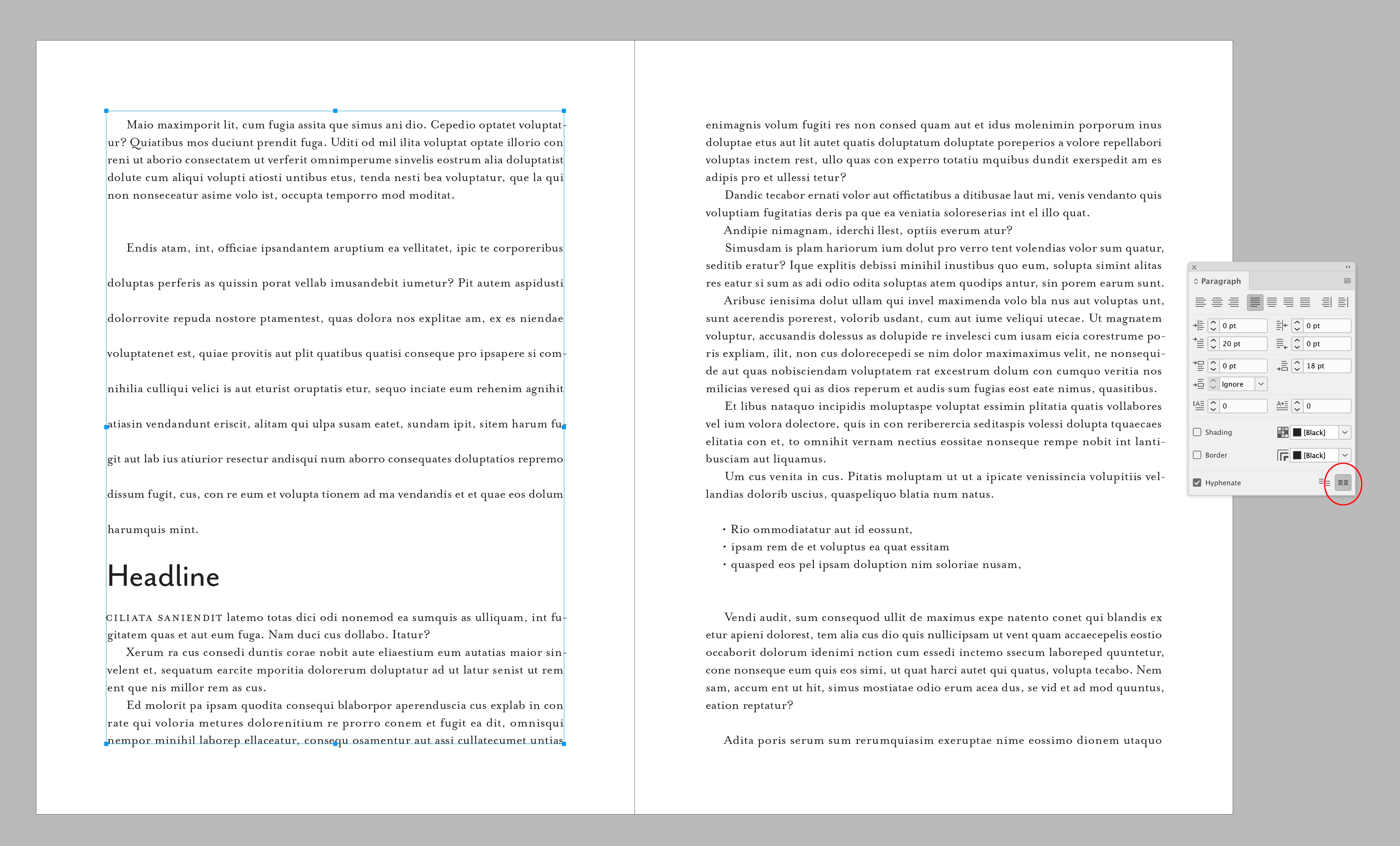

Thank you for your first stab at this! Here is a documenting illustrating my problem:
You can see that the the pages in the spread do not align (see the grey dotted lines I've drawin in).
I'm looking for help to script / control style sheets so that the right page also ends at the left page, so that there is no extra space on either page (i.e. the red arrow I've drawn on).
