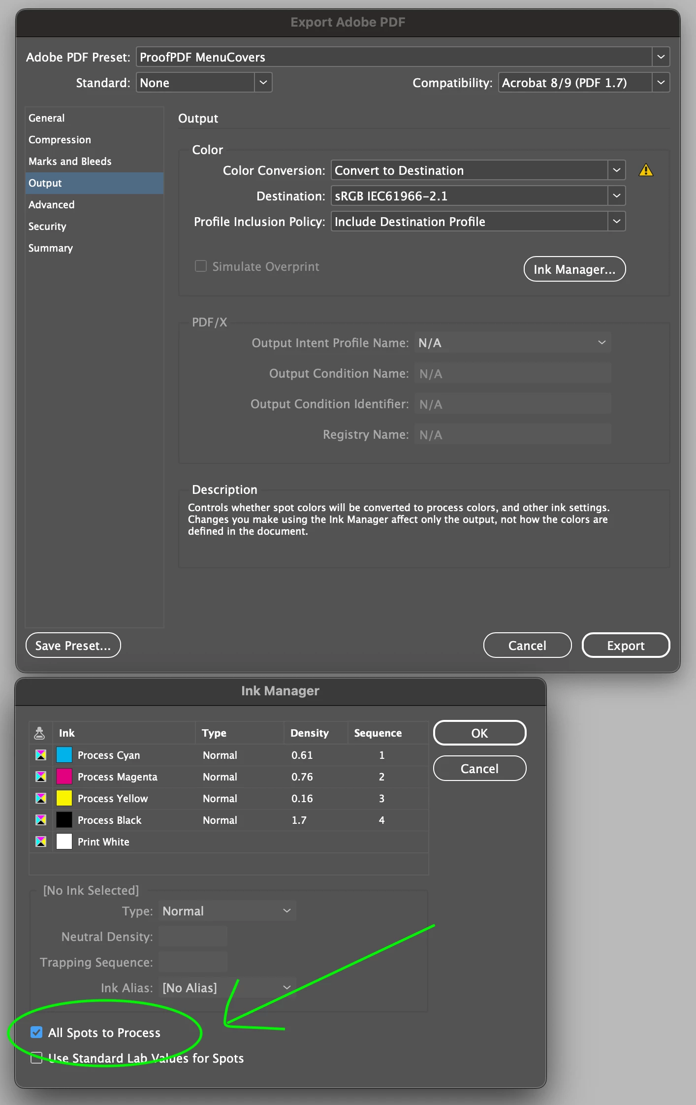

Is it possible to have All Spots to Process stick as part of a PDF export preset?

Thanks all for the feedback. I was just looking at the request as part of the export pre-set, not running a script, converting in Acrobat or using the checkbox in the Ink Manager settting. I've added a feature request, for what it's worth.

Well in case it's not obvious - the answer is no.
The only way I could do it is by exporting to Interactive PDF which would do it  and doesn't require a script.
I offered a script for a double click or assign a shortcut to it as a offering to make it easier.
Others have created more robust scripts that does it.
So you can make an interactive PDF - either manually or using my attempt of a script
Use one of the scripts posted here.
Or convert in Acrobat after you export
Or convert swatches before making a PDF.
Or I think someone mentioned using the ink manager also.
So there's no direct way - but if you need it it can be done.
You could be a while waiting for a solution from Adobe.

I personally just do the switch in the Ink Manager in InDesign before export. You can always toggle back to spots (as a whole or selectively) if you need them spot for another purpose.

Can't be done in the UI (as far as I know).
Can probably be done with a script that's invoked "on export".
