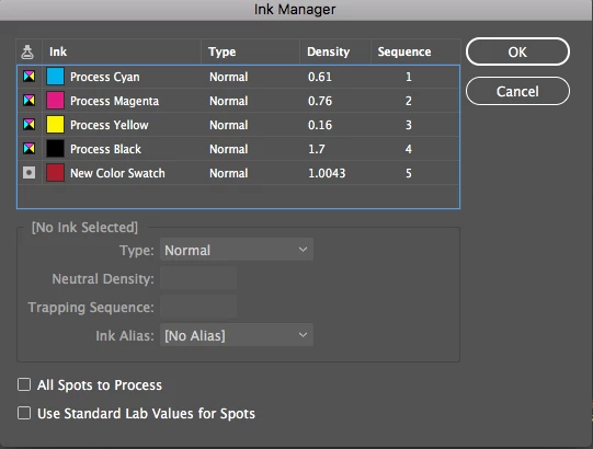

The most recent update to InDesign 19 has made the PDF preset option (under output) of "all spots to process" no longer available (it is grayed out). I am using a profile based on PDF/X-4 with color conversion set to convert to destination with destination set to Working CMYK - U.S. Web Coated which is what my printer requested and which I have been using for this project for over a year. My document contains may advertisements created by others which contain spot colors which must be converted to CMYK for the final output.
Why is the all spots to process no longer available.
I do see that if I select as the destination "no color conversion", the spot colors are removed, but I hesitate to go that route as it is not what my printer requires.
What are others doing in this case?

    I noticed that if there is no spot colors in the document, this option will be grayed out.
    June 12, 2019
    Hi Manal,
    see into reply 4 above where a screenshot is showing a very strange state of the checkbox:
    [-] All Spots to Process

    seems like some inks checked as --All spot to process but not all... meas that this check box work for selected inks.. not for ALL.

    did you check the settings of the Ink Manager ?
    There you could convert all Spots to Process.
    Uwe

    Yes, sorry, I wasn't clear enough. It is in Ink Manager with the option of all spots to color is grayed out.

    can you show a screenshot of all swatches in the Swatches panel plus the Ink Manager opened from the options you see with the Swatches panel? Are there any spot colors in the document? Usually the option to convert spots to CMYK is grayed out in the Ink Manager if there are no spots in the document.
