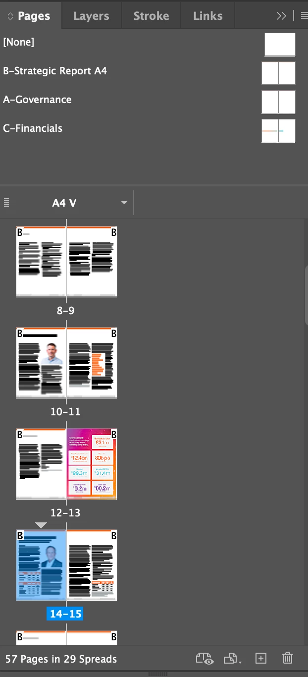

Can you post a screenshot of a single Spread?
Do you have 2xA5 vertical = A4 horizontal?
Apr 23, 2025 7:17 PM UTC
Not sure if this answers your question: my spreads are made up of facing A4 pages like this.
