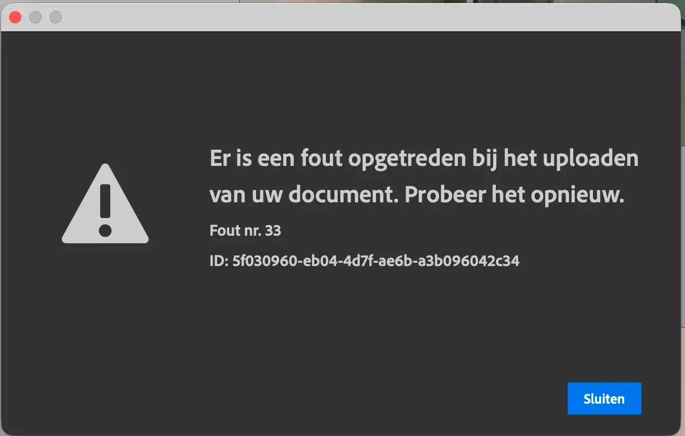

When I try to overwrite/update an existing document with Publish Online, I eventually get the following error: "An error occurred while uploading the document. Please try again. Error #33". Normally, I first see a progress bar regarding the preparation of the document, followed by a progress bar regarding the uploading of the document. The only thing being shown is the second progress bar: the uploading of the document. This happens faster than normal, after which you receive this error message: "An error occurred while uploading the document. Please try again. Error #33". Can anyone help me with this?

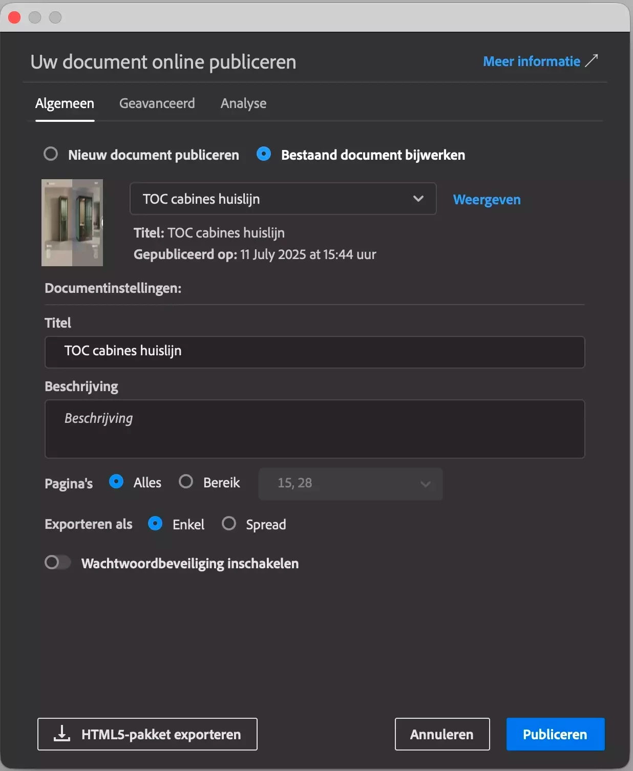

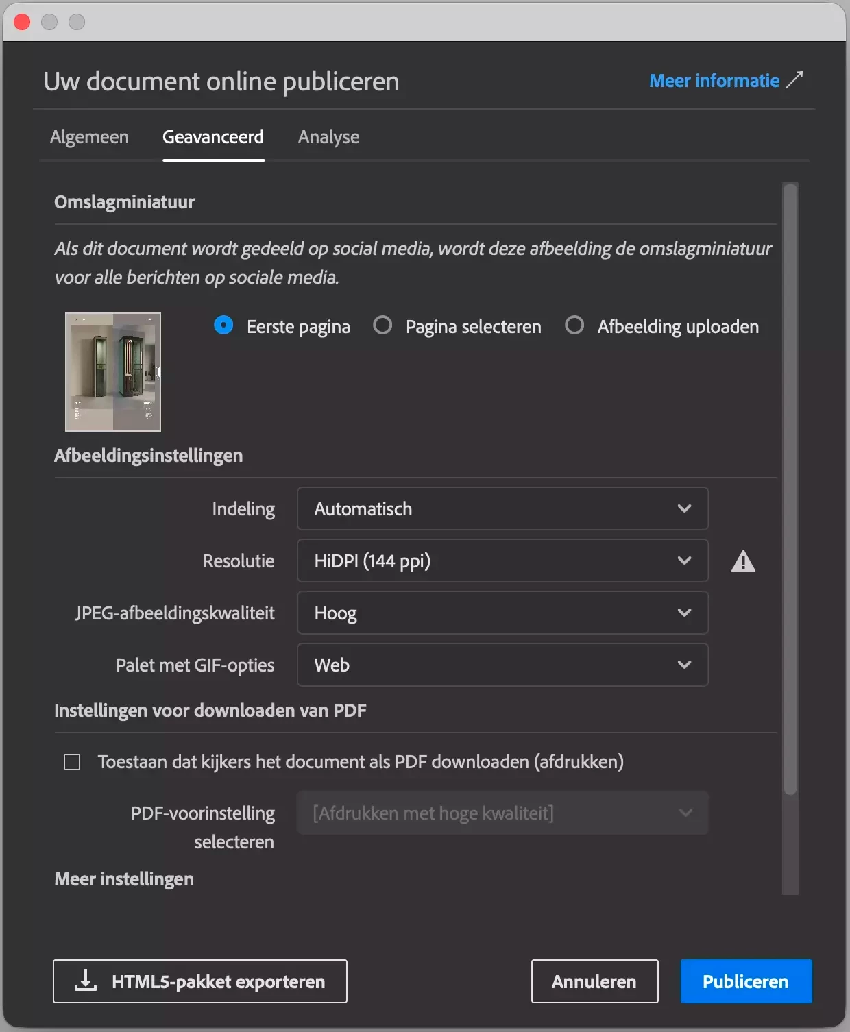

    Jun 11, 2026 7:39 AM UTC
    Here some more details (screenshots of the settings)
