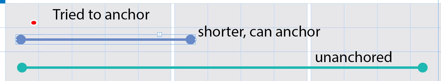

I work with a table-heavy handout that I need lines going across multiple cells. I have to add and subtract rows month after month, so I'm constantly shifting the cells. If my line is shorter, I can anchor it in the cell and it will span the length. However, if I have a longer line, it becomes overset in that cell and I can't figure out why.
Here are some of things I've tried:
  • Changing the inset spacing of the cell
  • Changing the height of the cell.
  • Changing the alignment of the cell
  • Changing the paragraph indent
  • Changing the to a graphic cell and pasting a vector object or image (with & without "contents clipped to cell" checked)
Changing the width of the cell will make it appear but that is not a solution for me since I need every column the same width. I also cannot merge the cells as i need a stroke on the border to differentiate them.
Screenshot attached. I'm only showing three rows here but i have rows on rows on rows. Probably 200 rows over three different tables.
I desperately want all the lines anchored. Please help!

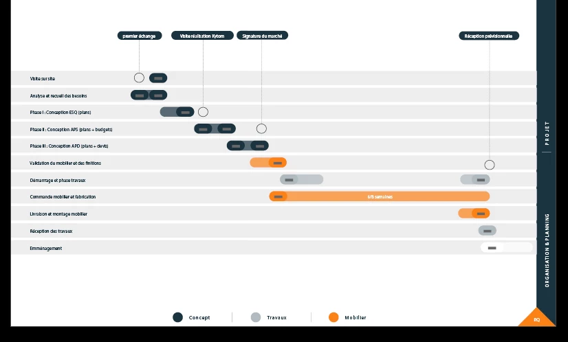

Something like this?
It's not done using Tables and Cells - as it would be too complicated - but generated from TextFile - prepared in Excel or something.
I can't zoom in too much - not my file - but it's a "timeline" for tasks - which, I assume, is what you are looking for to achieve.
Of course graphical representation is up to you.

I'm not talking about anything done manually - everything would be "virtually" linked so if you add/remove row - everything will shift as needed - can you show whole page?
