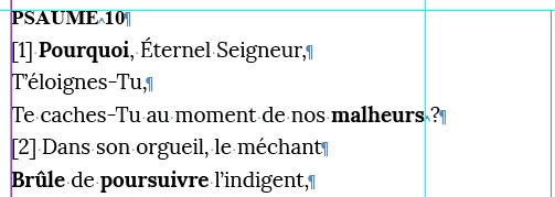

What is the script to programmatically extract all numbers enclosed in square brackets (e.g. [12]) from a text frame in InDesign, create anchored text frames on the left side of the main text flow for each, and apply a specific paragraph style (e.g. 'Number Style') to the extracted numbers within those anchored frames?

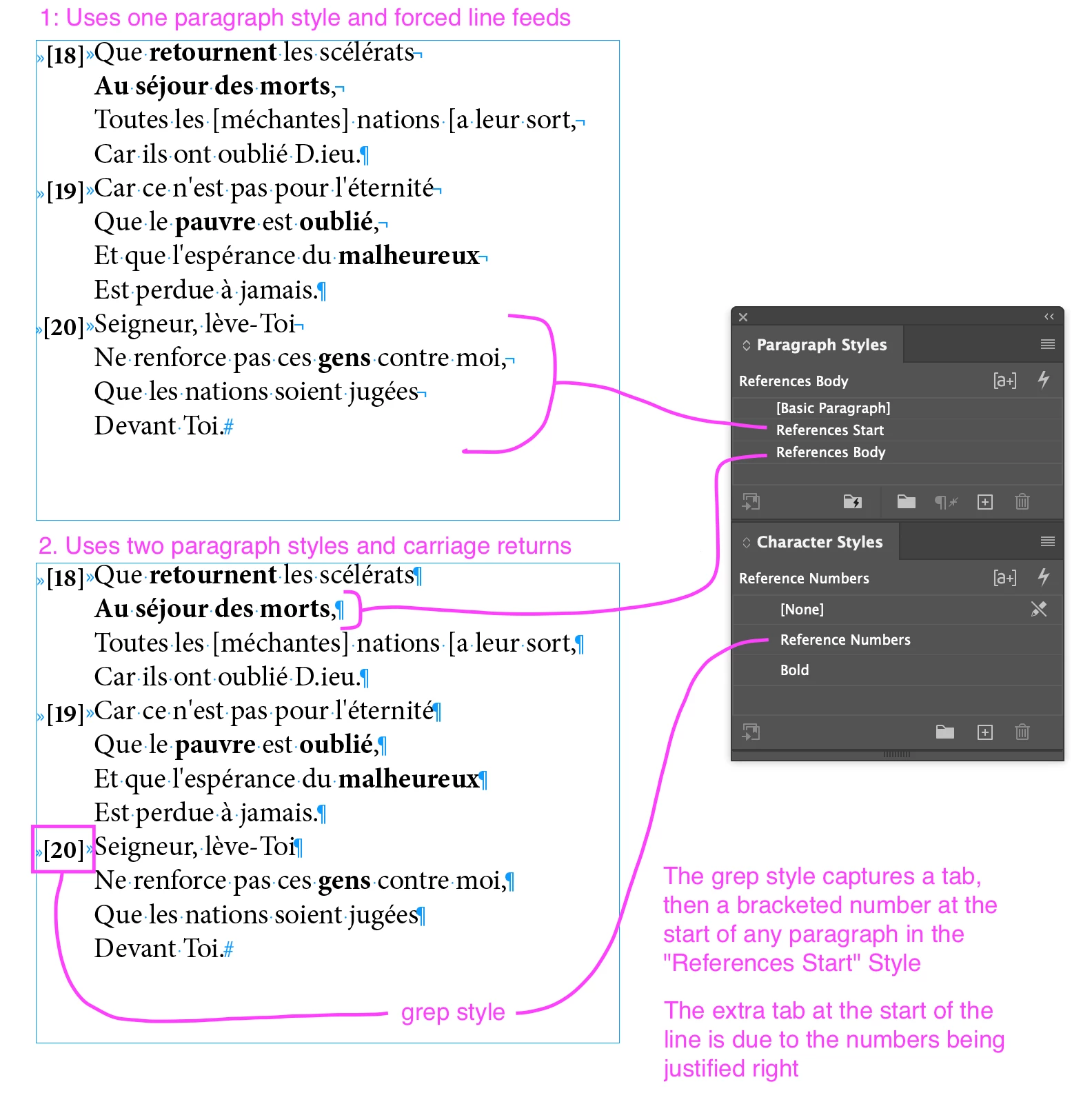

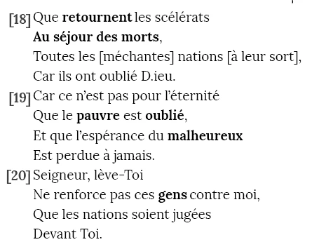

Hi @Dafna367384030n39 did you get anywhere with this? As Dave and Robert mentioned, a more-usual approach to this would be to use a "hanging indent" where the text is indented, say 10mm and the first line only is "indented" by –10mm so it lines up with the column edge again.
Here's a quick mockup in Indesign for you to look at. Open the attached demo.indd. But if that still isn't what you need, let us know.
- Mark
Here's annoted screenshot, too:
