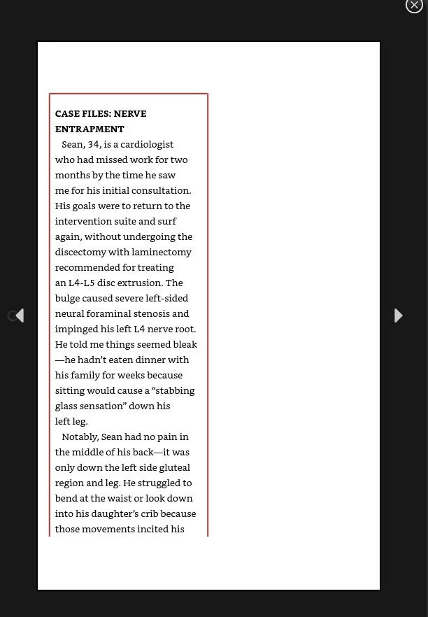

I have a medical book with lots of images and captions. The author / creator put all captions and notes in separate text boxes, and so as I'm trying to prepare this for export to epub, I am running into problems. I've just been adding the captions into the main text thread which works fine, but for some of his notes, there is also a stroke around the text box, so I would love to just anchor those to the main body text to keep the text frame options and stroke. This is what always happens to it when I do, though (see image), it still reflows the text but on only half the screen, no matter what size screen I'm looking at it on. I'm viewing it on a Kindle previewer, but any other app or viewer does the same thing. Any ideas?

Thanks for replying! I appreciate it! That's kind of what I was afraid of. I was so close to having it all! I can have a note in a text box, with a stroke of my choice, reflowable text, in the right location in the text, but I have to be OK with it on half the screen. It is like it thinks it is one of two columns, or something. Maybe I can convince the client that at least this is better than making the text box an image? Thanks again.

The width issue may be fixable as well; ID does laboriously preserve set or effective width on frames, so if they are 2 inches wide in the doc, tehy will be exported at 2 effective inches wide in the EPUB. That can be fixed with either styling in the document or another CSS code snippet.
