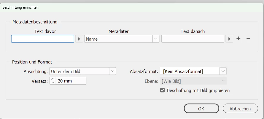

Just to add to Jan's correct comment: notice two things:
1. Setup the Captions dialog box (Object > Captions > Caption Setup) completely, including the tiny "Group" switch turned on. Also important is to setup a Captions paragraph style and the standoff distance.
2. Most important is the Metadata field. Set it to Description. Thereafter in Adobe Bridge, choose your image asset and add the metadata into that same named Description field and click the tiny check mark Save switch at the bottom of the metadata panel in Bridge.
Once the metadata is added to the image file, back in InDesign you can select the image, right-click it and choose Captions > Generate Live Captions, and a sequence of things interact, giving you a grouped/captioned/styled/positioned image.
https://helpx.adobe.com/in/indesign/using/captions.html

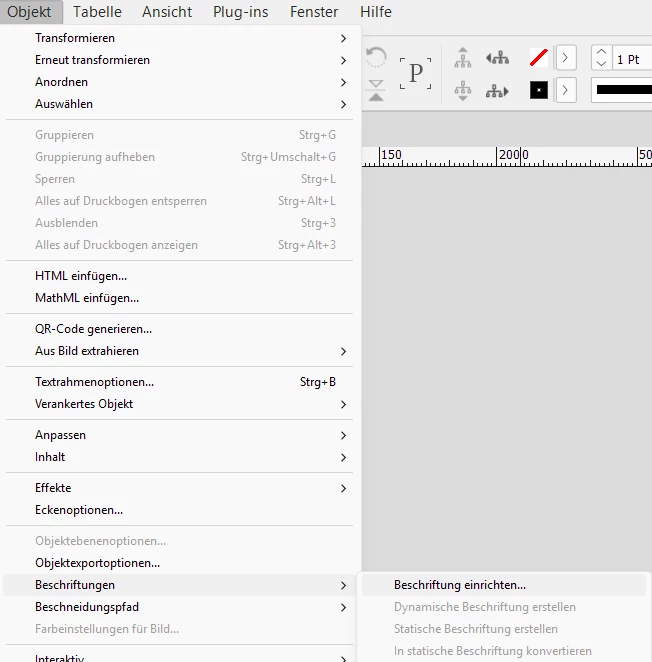

Jun 10, 2025 12:40 PM UTC
Hey Ali,
your solution is to "group" imagebox and textbox, and luckly there is an option for this. Maybe the translation is different, im on a german client.
Go to Object, Captions, Setup Captions...
Here you are able to have your captions grouped with the text. Also you can set the space between photo and text.
Also, you can set a paragraph-style exspecially for the captions.
