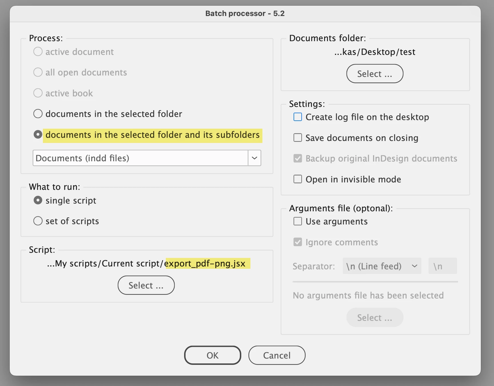

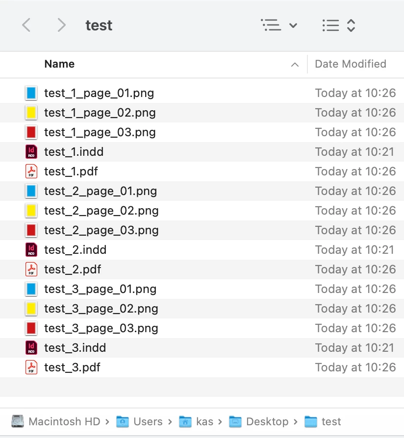

Change PNG export prefs to whatever you need.
In a perfect world, this script would work on all open documents (I generally open 32 at a time), but I think that's pushing it. Any help is appreciated.
It's possible with my Batch processor script. You can process all files in one go, running them through all folders and subfolders.
