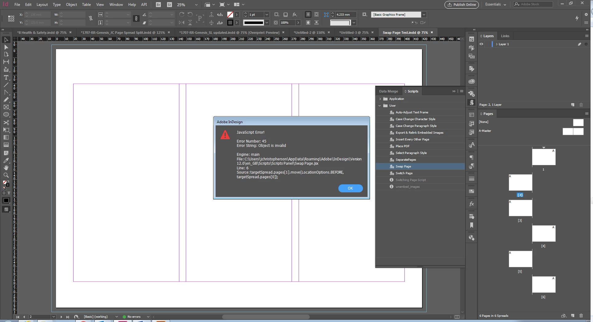

August 1, 2017
Thanks for the answer!
I tried to run the script but got an error.
I suppose the crux of my problem is that I'm trying move page 3 (as shown in the image attached) from the left hand edge to the right and page 4 to the left and repeat that for all pages after page 2 in the document, so that my pagination is correct.
I have a master which is a 2 page spread as its handy to apply 1 master to all of the document instead of having one master for left and another for right hand pages (which would need to be manually reapplied if i add or remove a page)
I have the layout split like that because I produce spiral bound documents, so I need a bleed on the spine.
Any advise on how I can go about this is much appreciated, thanks for your time!
