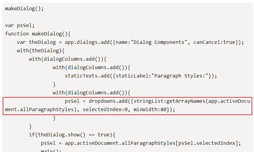

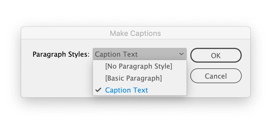

Hi @vistarmedia@gmail.com , Here’s an example for getting a paragraph style from a dropdown:
makeDialog();
var psSel;
function makeDialog(){
    var theDialog = app.dialogs.add({name:"Dialog Components", canCancel:true});
    with(theDialog){
        with(dialogColumns.add()){
                    staticTexts.add({staticLabel:"Paragraph Styles:"});
                    psSel = dropdowns.add({stringList:getArrayNames(app.activeDocument.allParagraphStyles), selectedIndex:0, minWidth:80});
        if(theDialog.show() == true){
            psSel = app.activeDocument.allParagraphStyles[psSel.selectedIndex];
            main();
            theDialog.destroy();
function main(){
    alert("\rChosen Paragraph Style: " + psSel.name);
* Returns a list of style names from the provided array of styles.
* Note does not work with a collection allParagraphStyles is an array paragraphStyles is a collection
* @ param the object array
* @ return array of names
function getArrayNames(arr){
    var a = new Array;
    for(var i = 0; i < arr.length; i++){
        a.push(arr[i].name);
    return a
rob day

September 27, 2023
Thank you very much! for some reason, InDesign was giving an error referring to this code snippet with a drop-down list. Specifically on getArrayNames.
Then I replaced this line with this one (I have paragraph styles nested in a group):
var selectedStyle = dropdowns.add({stringList: app.activeDocument.paragraphStyleGroups.item(0).paragraphStyles.everyItem().name, selectedIndex: 0});
And then everything worked as it should!
Thanks again! You solved a problem I've been working on for almost a week in an instant)

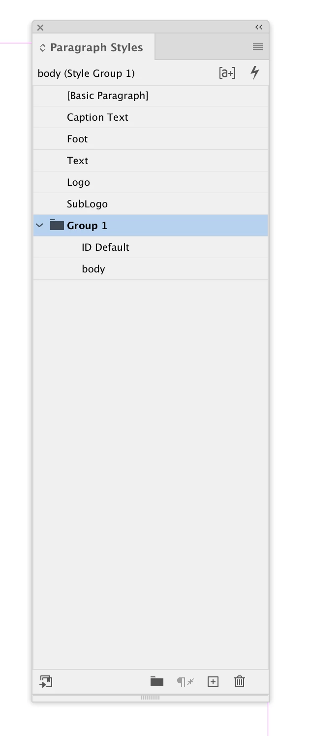

September 27, 2023
Just note in case you don’t know—you can get all of the document’s paragraph style, grouped or not, via the .allParagraphStyles property. It returns an array, not a collection, which is why I included the getArrayNames function in my code—you would have to add the same function to your script. Your code would get an array of paragraph styles in the document’s first group, but not from other groups.
For example with this style setup:
//Returns Group 1 styles ID Default,body
$.writeln(app.activeDocument.paragraphStyleGroups.item(0).paragraphStyles.everyItem().name)
While this gets all of the styles:
$.writeln(getArrayNames(app.activeDocument.allParagraphStyles))
//returns [No Paragraph Style],[Basic Paragraph],Caption Text,Foot,Text,Logo,SubLogo,ID Default,body
    var a = new Array;
    return a
