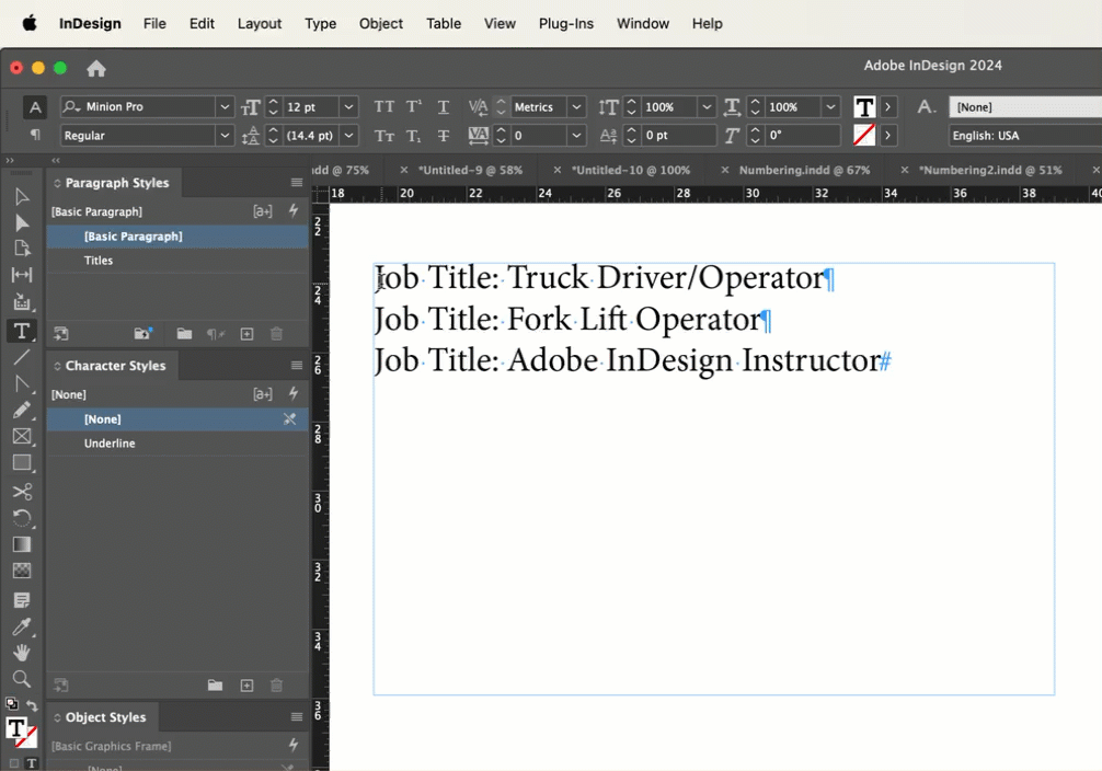

Hi everyone,
I’m trying to apply paragraph shading to a specific text segment (e.g., "Job Title:") with rounded corners in InDesign while leaving the rest of the text (e.g., "Truck Driver/Operator") unshaded. I also want to change the font style and size for the shaded part and then remove the colon ":" after applying the styles.
I’ve attempted this using paragraph styles and characters style in nested styles,  but the paragraph shading is being applied to the entire line instead of just the specific segment. I need a way to:
  1. Apply paragraph shading with rounded corners to only the selected text (e.g., "Job Title:").
  2. Change the font and size for the shaded portion.
  3. Remove the colon ":" after applying the styles.
  4. Do this efficiently for multiple headings.|
Any guidance on how to achieve this would be greatly appreciated!
Thanks!

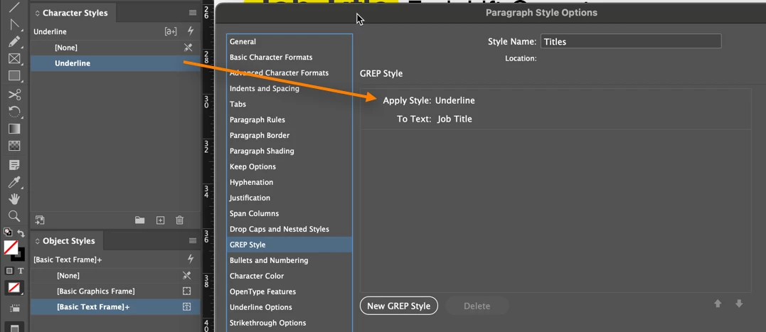

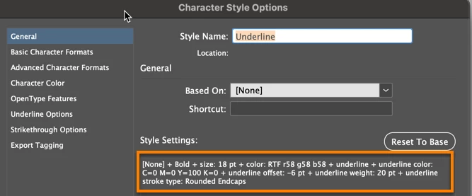

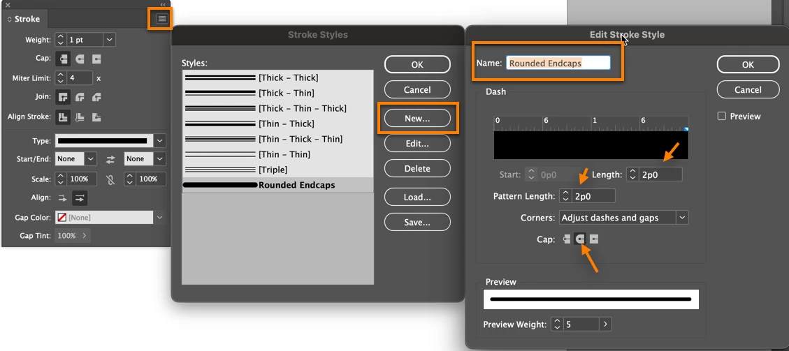

Hi @Muhammad Sattar:
This is a visual of Mike's approach, which seems pretty straightforward/stable to me.
  • First I ran a find/change to add spaces before and after "job title", and to remove the colon
  • I created a custom underline called Rounded Endcap
  • Then created a character style to make the Rounded Endcap thicker and assign the offset so that it appears behind the text (and changed the type size and weight)
  • And finally, assigned it via a GREP Style
~Barb
