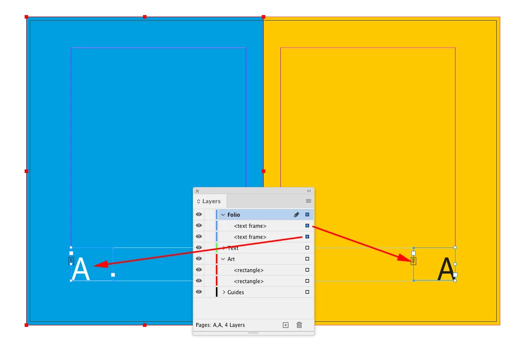

rob day
July 24, 2021
Usually you don’t want to override master page items unless they need to be edited, so if you follow Scott’s suggestion of putting the page numbers on their own layer above other layers, there will be no need to override and move each folio:

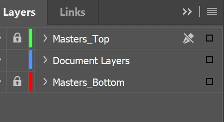

Dave Creamer of IDEAS
July 25, 2021
To add to Scott's answer, you can have multiple layers for the masters.
For example, one below the document layer(s) for items you want below document objects, and one above for items you always want on top of document objects. Lock the master layers so you don't accidently put objects on them.
TomToledo
TomToledoAuthor
July 25, 2021
Good tip.  I have not locked the master top layer yet, and I will!
