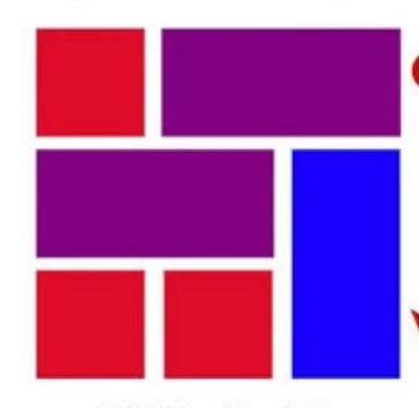

Hello
The script below sorta works but fails in bits - below is the background
I want to make a script which can auto make a grid of graphic frames of different sizes, neatly laid out like the screenshot below
I want the user to draw a retectangle the size of the area they want the grid to be, then run the script which prompts the amount of boxes and gutter between them
the script then auto makes a grid of random sizes mainting the gutter
the script could make the random box sizes based on a multiple of cell size if one was to think of the space being devided into cells - rows and columns so frames could span 1x3 or 2x2 etc
My script generates the boxes at different sizes which seems good
but it doesnt make them big enough to match the same size area as the user selection nor does it follow the gutter width, nor does it prevent overlapping.
Any ideas on where to fix it  - also i do have a scipt I made which makes a grid based on user input which is sorta what I am using the base this new script on.
Thanks all
Tricky one this!!
