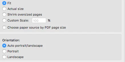

    July 18, 2019
    Would it be possible for you to print from Acrobat?
    There is an "auto-rotate" option in the Print Dialog.
