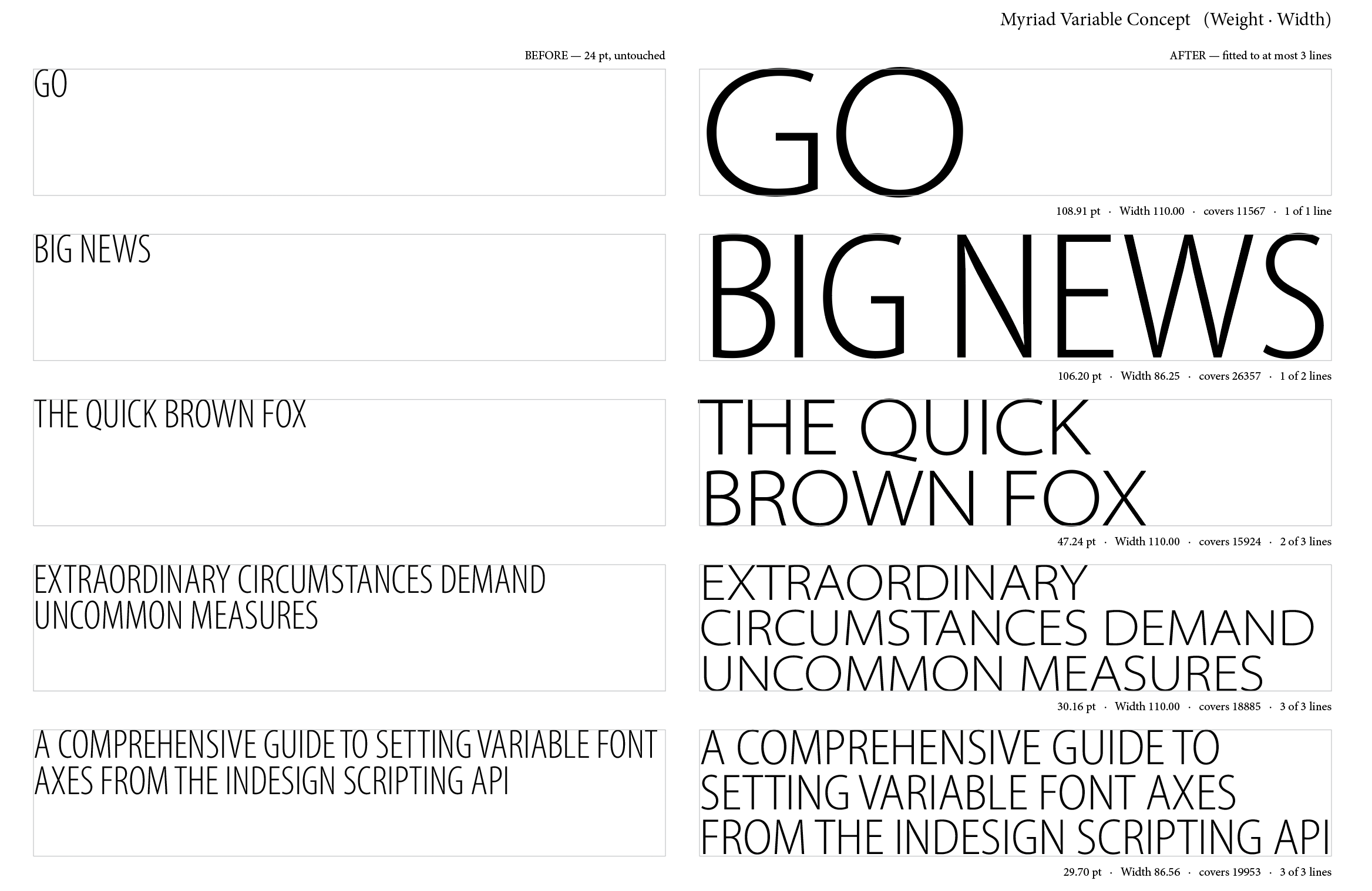

    m1b
    Sep 1, 2026 9:50 PM UTC
    Hi ​@kind_Ray39fb I’ve written a text-fitting function previously and I’ve updated it to work with variable width fonts. To try it out, select a text box and run the below script. If it works the way you want feel free to include it in your current script. I tested with a couple of default variable fonts I had on my system here so let me know if your font works as expected.
    – Mark
    * @file fitHeadingToFrame.js
    * Auto-sizes a heading to fill a fixed text frame, using a variable font's
    * width axis where there is one, so that the type is never distorted by
    * horizontal scaling.
    * We score each setting by the AREA the text consumes (larger area, better score).
    * 1. measure the font's cap height ratio at each sampled width (cached);
    * 2. at each sampled width, binary-search the largest point size that
    * composes within the target number of lines without overflowing;
    * 3. keep the width covering the greatest area, preferring the widest
    * setting when several cover near enough the same.
    * Can handle non-variable font, but won't always fit quite as well.
    * `widthTrimLow` and `widthTrimHigh` fence off each end of the axis as a
    * percentage of its full span, so the same pair of numbers means the same thing
    * whatever a font's raw axis numbers happen to be. For an axis running 50 to
    * 115, a span of 65, passing 5 and 20 allows 53.25 to 102.
    * Hyphenation is forced off, and the target line count is therefore
    * Math.min(number of words, `lineCount`) — without hyphenation a heading cannot
    * break over more lines than it has words.
    * Run with one or more text frames selected, or call fitHeadingToFrame() from your
    * own script. (set `$.global.FIT_HEADING_TO_FRAME_AS_LIBRARY = true; in the entry script`)
    * @author m1b
    * @version 2026-09-02
    * @discussion https://community.adobe.com/questions-671/automating-a3-in-store-signs-how-to-fit-variable-length-names-to-a-fixed-frame-without-distorting-type-1636918

    if (undefined === chosen)
    throw new Error('fitHeadingToFrame: the text will not fit into ' + targetLineCount + ' line(s) even at ' + minPointSize + ' pt.');
    } else {
    // scan the width axis, scoring each setting by the area of frame the
    // heading actually covers — wider letterforms and an extra line both
    // raise it, so the scan prefers a heading that fills its frame
    // trimming can collapse the range to a single value, which is a
    // legitimate way to pin the axis rather than an error
    var sampleCount = ((maxWidth - minWidth) < widthTolerance) ? 1 : widthSampleCount;
    var widthStep = (1 === sampleCount) ? 0 : (maxWidth - minWidth) / (sampleCount - 1);
    var candidates = [];
    var bestCoverage = 0;
    for (var i = 0; i < sampleCount; i++) {
    var candidate = evaluateWidth(minWidth + (widthStep * i));
    if (undefined === candidate)
    continue;
    candidates.push(candidate);
    if (candidate.coverage > bestCoverage)
    bestCoverage = candidate.coverage;
    if (0 === candidates.length)
    // of the widths that cover near enough the same area, take the widest —
    // the candidates are in ascending width order, so the last one wins
    chosen = candidates[0];
    for (var i = 0; i < candidates.length; i++) {
    if (candidates[i].coverage >= bestCoverage * (1 - tieTolerance))
    chosen = candidates[i];
    // the scan lands on fixed steps, so creep further along the axis
    // while the heading still covers near enough the same area
    var low = chosen.width;
    var high = Math.min(maxWidth, chosen.width + widthStep);
    while (high - low > widthTolerance) {
    var middle = (low + high) / 2;
    var refined = evaluateWidth(middle);
    if (
    undefined !== refined
    && refined.coverage >= bestCoverage * (1 - tieTolerance)
    chosen = refined;
    low = middle;
    } else {
    high = middle;
    setDesignAxis(text, baseAxes, widthAxisIndex, chosen.width);
    text.pointSize = chosen.pointSize;
    return {
    pointSize: chosen.pointSize,
    apparentSize: chosen.apparentSize,
    coverage: chosen.coverage,
    widthAxisName: hasWidthAxis ? axisNames[widthAxisIndex] : null,
    widthAxisValue: chosen.width,
    designAxes: hasWidthAxis ? text.designAxes : null,
    lineCount: text.lines.length,
    targetLineCount: targetLineCount,
    font: text.appliedFont
    } finally {
    app.scriptPreferences.measurementUnit = savedMeasurementUnit;
    app.scriptPreferences.enableRedraw = savedEnableRedraw;
    * Binary-searches for the largest value between `low` and `high` for which
    * `test` returns true, assuming `test` is true up to some threshold and false
    * above it.
    * @author m1b
    * @version 2026-09-01
    * @param {Number} low - the lowest value to try.
    * @param {Number} high - the highest value to try.
    * @param {Number} tolerance - how close to the threshold to get.
    * @param {Function} test - a function(value) returning a Boolean.
    * @returns {Number|undefined} - the largest passing value, or undefined if even `low` fails.
    function largestPassing(low, high, tolerance, test) {
    if (test(high))
    return high;
    if (!test(low))
    return undefined;
    var best = low;
    while (high - low > tolerance) {
    if (test(middle)) {
    best = middle;
    low = middle;
    } else {
    high = middle;
    return best;
    * Returns the total width of every line of `text`, in points. The horizontal
    * half of the covered-area score.
    * Note: `horizontalOffset` and `endHorizontalOffset` are absolute positions, so
    * the difference is the line's width whichever way round they run.
    * @author m1b
    * @param {Text} text
    * @returns {Number}
    function getTotalLineWidth(text) {
    var lines = text.lines;
    var total = 0;
    for (var i = 0; i < lines.length; i++)
    total += Math.abs(lines[i].endHorizontalOffset - lines[i].horizontalOffset);
    return total;
    * FONT HELPERS *
    * Returns a font's cap height at a given width axis value, as a fraction of the
    * point size. Measured, not looked up: InDesign exposes no cap height, but with
    * a cap height first baseline the first baseline sits exactly one cap height
    * below the top of the frame.
    * Results are cached on $.global for the session.
    * @author m1b
    * @param {Document} doc - a document to measure in.
    * @param {Font} font
    * @param {Array<Number>} [baseAxes] - the axis values to keep for every other axis.
    * @param {Number} axisIndex - the width axis, or -1 for a font without one.
    * @param {Number} [widthValue]
    * @returns {Number} - cap height divided by point size, eg. 0.668.
    function getCapHeightRatio(doc, font, baseAxes, axisIndex, widthValue) {
    if (undefined === $.global.capHeightRatioCache)
    $.global.capHeightRatioCache = {};
    var cacheKey = font.name + '|' + axisIndex + '|' + widthValue;
    if (undefined !== $.global.capHeightRatioCache[cacheKey])
    return $.global.capHeightRatioCache[cacheKey];
    // 'H' has flat caps, so its ink stops exactly at the cap line —
    // a round letter like 'O' would overshoot and read too tall
    var measuringFrame = doc.pages[0].textFrames.add({
    geometricBounds: [0, 0, MEASUREMENT_POINT_SIZE * 6, MEASUREMENT_POINT_SIZE * 6],
    contents: 'H'
    var ratio;
    try {
    measuringFrame.textFramePreferences.properties = {
    insetSpacing: [0, 0, 0, 0],
    firstBaselineOffset: FirstBaseline.CAP_HEIGHT,
    verticalJustification: VerticalJustification.TOP_ALIGN
    var sample = measuringFrame.texts[0];
    sample.appliedFont = font;
    sample.pointSize = MEASUREMENT_POINT_SIZE;
    if (-1 !== axisIndex)
    setDesignAxis(sample, baseAxes, axisIndex, widthValue);
    ratio = (sample.lines[0].baseline - measuringFrame.geometricBounds[0]) / MEASUREMENT_POINT_SIZE;
    } finally {
    measuringFrame.remove();
    $.global.capHeightRatioCache[cacheKey] = ratio;
    return ratio;
    * Returns the font applied to `text`, throwing if the text does not have a
    * single font throughout.
    * Note: a variable instance's font name encodes its axis values, so matching
    * names also means matching design axes.
    * @author m1b
    * @returns {Font}
    function getUniformFont(text) {
    var ranges = text.textStyleRanges;
    var first = resolveFont(ranges[0].appliedFont);
    for (var i = 1; i < ranges.length; i++) {
    var other = resolveFont(ranges[i].appliedFont);
    if (other.name !== first.name)
    throw new Error('fitHeadingToFrame: the text does not have a single font throughout — found "' + String(first.name).replace('\t', ' ') + '" on "' + ranges[0].contents + '" and "' + String(other.name).replace('\t', ' ') + '" on "' + ranges[i].contents + '".');
    return first;
    * Returns a Font, given either a Font or a font name, throwing if it does not
    * resolve to a font that is actually installed.
    * @author m1b
    * @param {Font|String} font
    * @returns {Font}
    function resolveFont(font) {
    var name = ('string' === typeof font) ? font : undefined;
    var resolved = (undefined === name) ? font : app.fonts.itemByName(name);
    if (
    !resolved
    || !resolved.isValid
    throw new Error('fitHeadingToFrame: the font ' + (undefined === name ? 'applied to the text' : '"' + name.replace('\t', ' ') + '"') + ' does not exist.');
    if (FontStatus.INSTALLED !== resolved.status)
    throw new Error('fitHeadingToFrame: the font "' + String(resolved.name).replace('\t', ' ') + '" is not installed — it is missing or substituted.');
    return resolved;
    * Returns the design axis names of a variable font, or an empty array for a
    * font that has no design axes.
    * @author m1b
    * @returns {Array<String>} - eg. ['Weight', 'Width', 'Slant'].
    function getDesignAxisNames(font) {
    try {
    // InDesign throws, rather than returning zero, for a non-variable font
    if (font.numDesignAxes > 0)
    return font.designAxesName;
    } catch (error) {
    // not a variable font, which is not an error here
    return [];
    * Returns the index of a named design axis, or -1.
    * @param {Array<String>} axisNames
    * @param {String} axisName
    * @returns {Number}
    function indexOfDesignAxis(axisNames, axisName) {
    var wanted = String(axisName).toLowerCase();
    for (var i = 0; i < axisNames.length; i++) {
    if (String(axisNames[i]).toLowerCase() === wanted)
    return i;
    return -1;
    * Sets a single design axis value on `text`, leaving the other axes at the
    * values given by `baseAxes`.
    * Note: `designAxes` is a flat array of reals, one per axis, in the order given
    * by the font's `designAxesName`, and every axis value must be supplied at
    * once. Values outside the font's range throw. (Beware that `designAxesRange`,
    * unlike `designAxes` and `designAxesValues`, is nested: one [minimum, maximum]
    * pair per axis.)
    * @author m1b
    * @param {Array<Number>} baseAxes - the axis values to keep for every other axis.
    * @param {Number} value
    function setDesignAxis(text, baseAxes, axisIndex, value) {
    var axes = [];
    for (var i = 0; i < baseAxes.length; i++)
    axes.push(baseAxes[i]);
    axes[axisIndex] = value;
    text.designAxes = axes;
    * GENERAL *
    * Returns the document containing a page item.
    * @param {PageItem} item
    * @returns {Document}
    function getDocument(item) {
    while (
    item
    && 'Document' !== item.constructor.name
    item = item.parent;
    return item;
    * Returns the selected text frames, including the frames of any selected text.
    * @author m1b
    * @returns {Array<TextFrame>}
    function getSelectedTextFrames() {
    var frames = [];
    var selection = app.selection;
    for (var i = 0; i < selection.length; i++) {
    var item = selection[i];
    if (item.hasOwnProperty('baseline'))
    // a text selection, rather than the frame itself
    item = item.parentTextFrames[0];
    if (
    item
    && 'TextFrame' === item.constructor.name
    frames.push(item);
    return frames;
