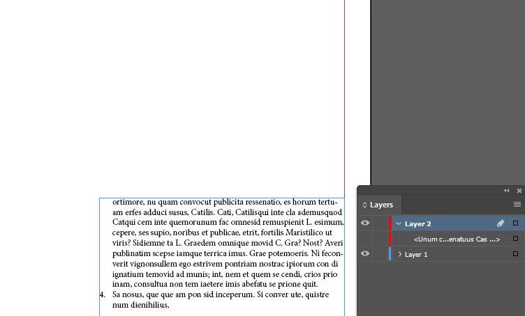

Steps to reproduce:
  1. Create 2 threaded text frames on a page.
  2. Fill them with text (Lorem ipsum)
  3. Autonumber the paragraphs with Autonumbering feature in InDesign - regular 1, 2, 3-list will do.
  4. Create a new layer
  5. Move the first frame in the text flow to that layer
  6. Turn off visibility of that layer.... The autonumbering is gone from any autonumbered list!!!
Did anyone else see this behaviour?

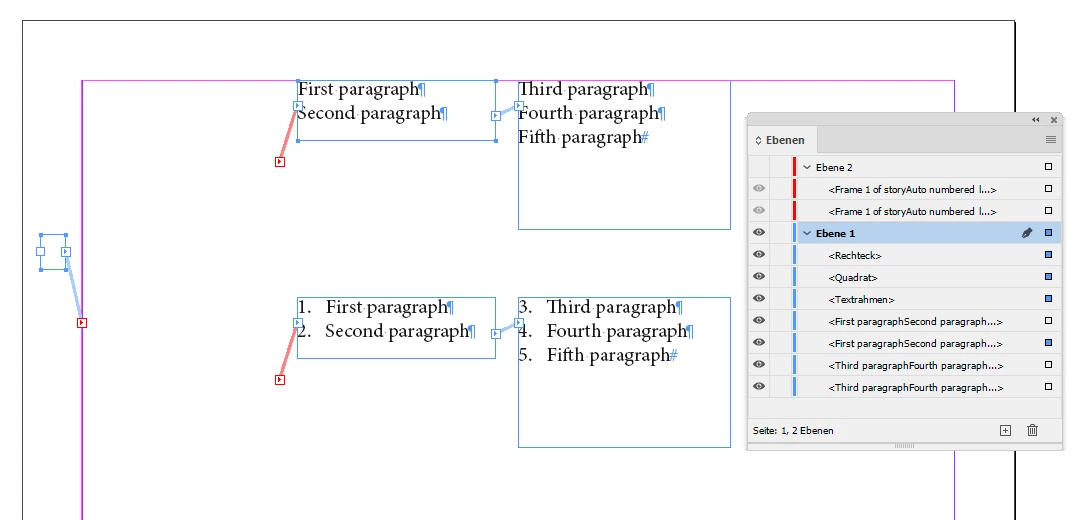

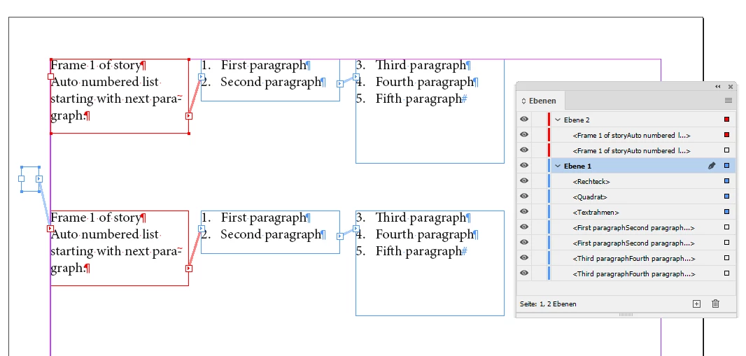

tested a bit. It seems it depends on the visibility of the layer of the first frame of the story:
Two stories with threaded text frames below.
One where the first text frame is on a layer I want to make invisible.
One where the second text frame is on a layer I want to make invisible.
Layer "Ebene 2" is still visible, all's normal, auto numbering is working:
Now watch the thread at the top where the first frame is on the layer I make invisible.
Auto numbering is not rendered! Not so in the story below where the first frame is on a layer that's visible:
So it is the first frame's layer visibility that dictates this issue!
Uwe Laubender

LaubenderCommunity ExpertCorrect answer
August 2, 2021
Hi Michael,
Uwe Laubender
( ACP )
