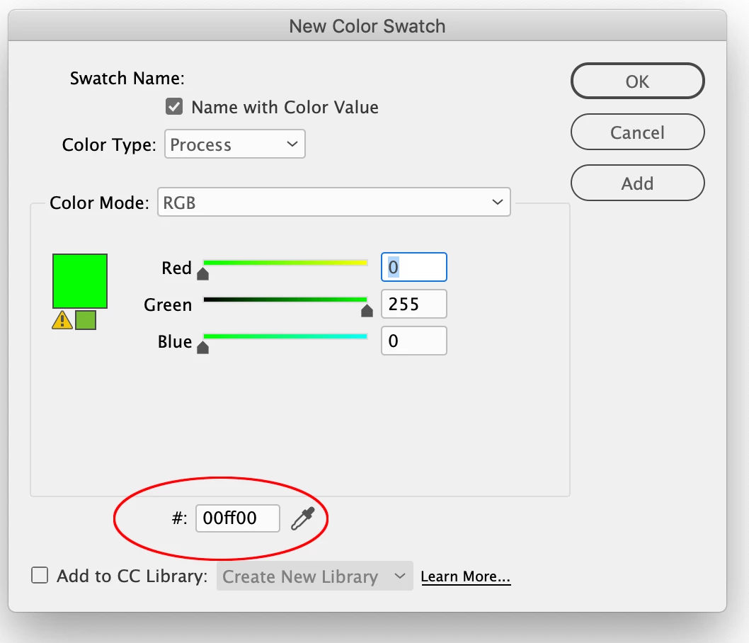

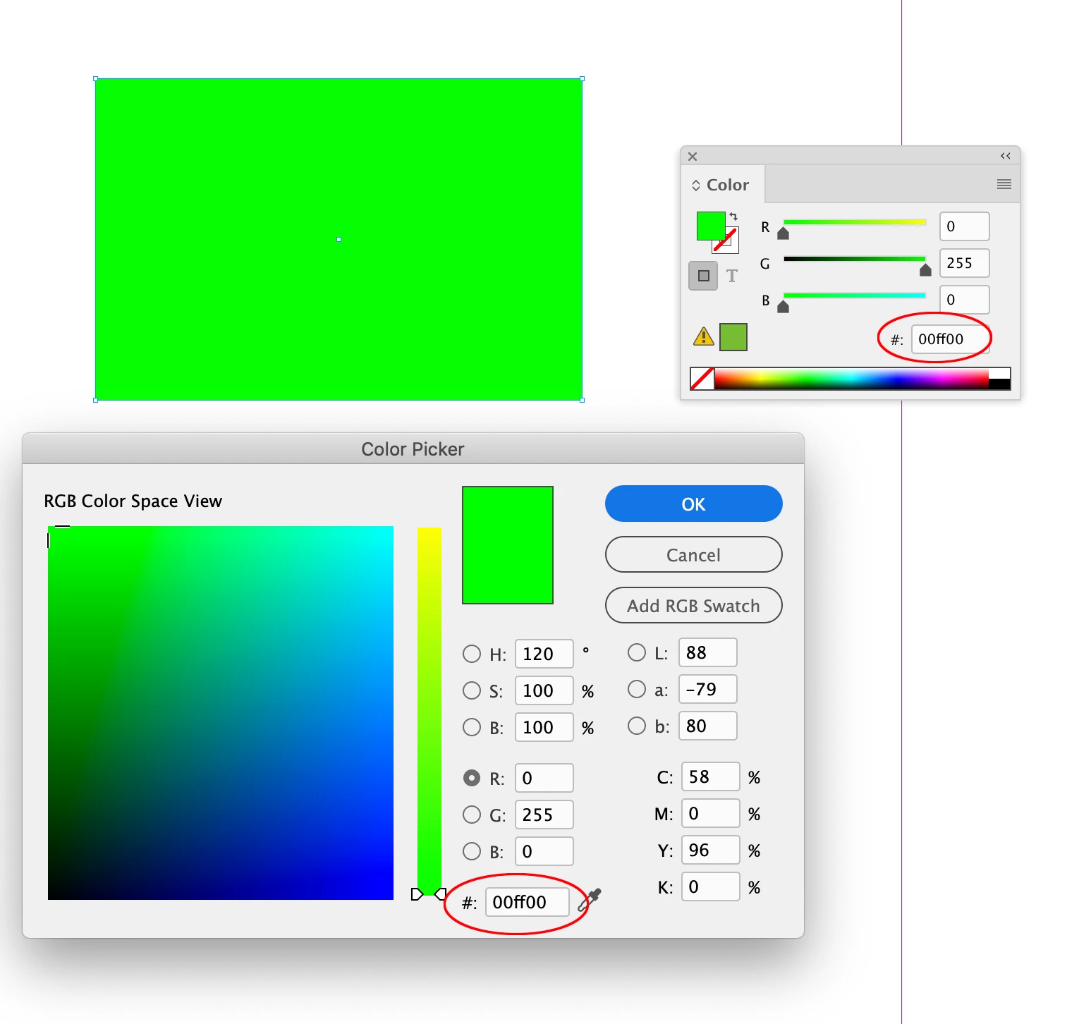

The Color, Swatches, and Color Picker panels let you spec RGB color as HEX. To get the same appearance as web HTML hex, assign sRGB as the document’s RGB profile.

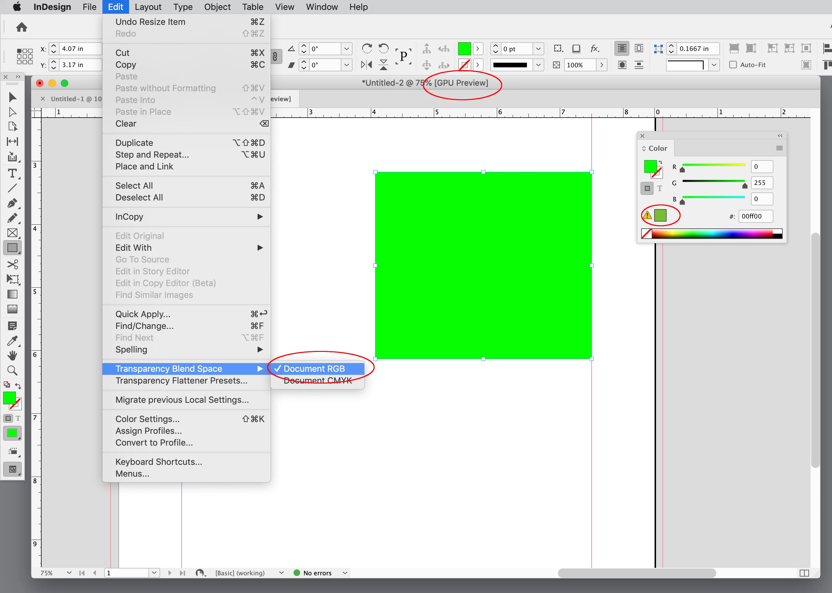

Hi @Brigit Ananya , If you are designing only for screens, set your Transparency Blend Space to RGB, your document's assigned RGB profile to sRGB (Edit>Assign Profiles...), and turn off Overprint Preview. Your pages will then preview without any gamut clipping.

Also, make sure you are not using Spot swatches, and you have View>Proof Colors turned off.
Can you show that happening in a screen capture? The warning would always show in the Swatches or Color panels, but an out-of-gamut RGB color should display unchanged, assuming the blend space is RGB, and Overprint preview is off:
