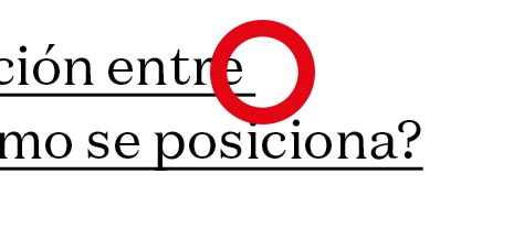

How can I avoid underlined spaces at the end of a line?

It is built-in behavior of InDesign. I wrote a script to apply a temporary fix to this years ago: http://indesignsecrets.com/topic/removing-end-of-line-underlines-83 (which I didn't remember but actually found by typing in your question into a well-known internet search engine).
The script contains a few characters that did not survive the translation to forum-formatted HTML, so I'll repeat it below for convenience:

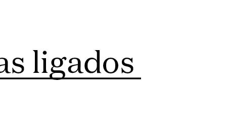

It's not on the end of the story, it's a paragraph that has multiple lines. I want when the line breaks, the space that is at the end of the line is not underlined. It would be easier to do it through a grep code, than doing it manually.
