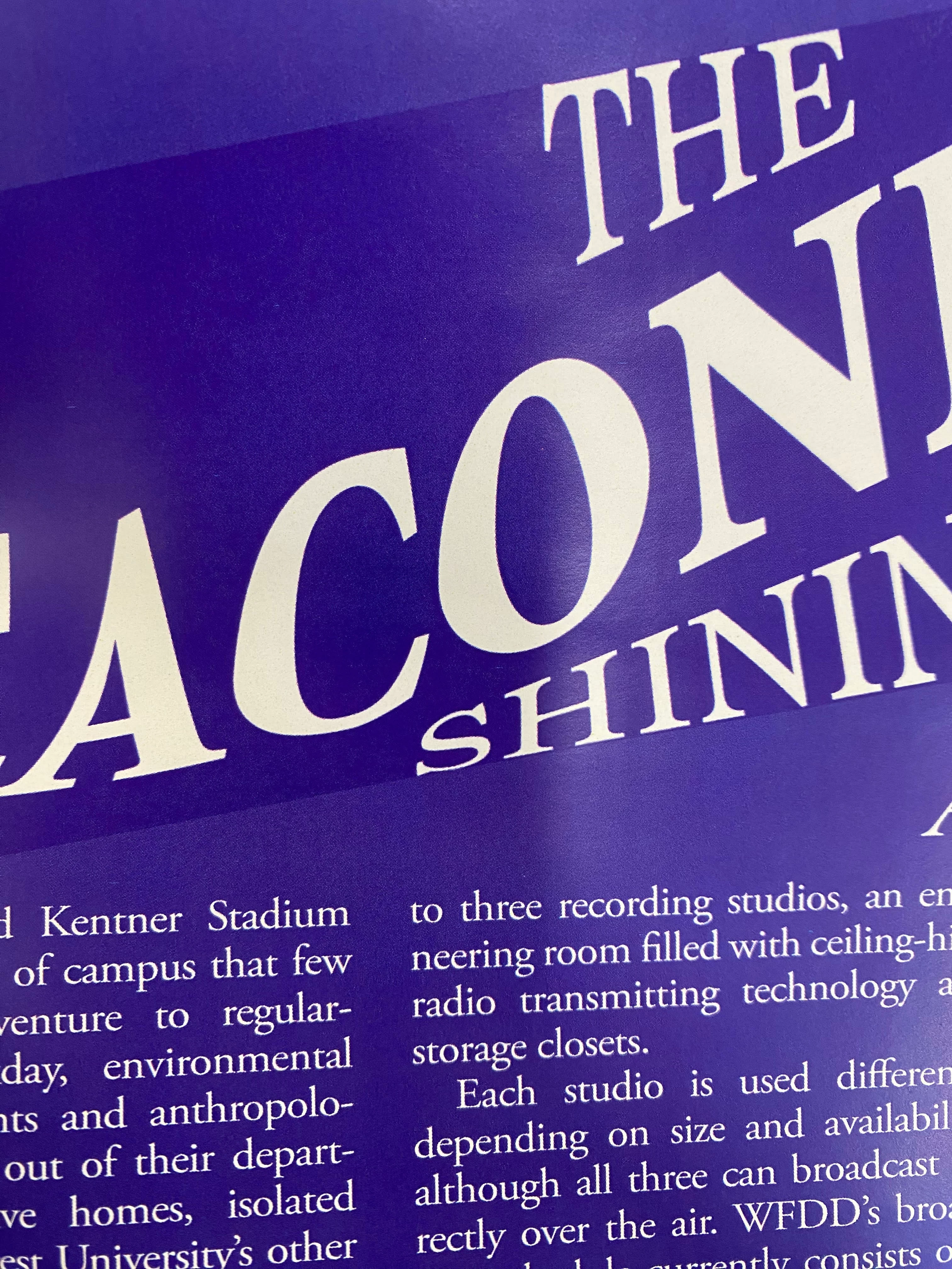

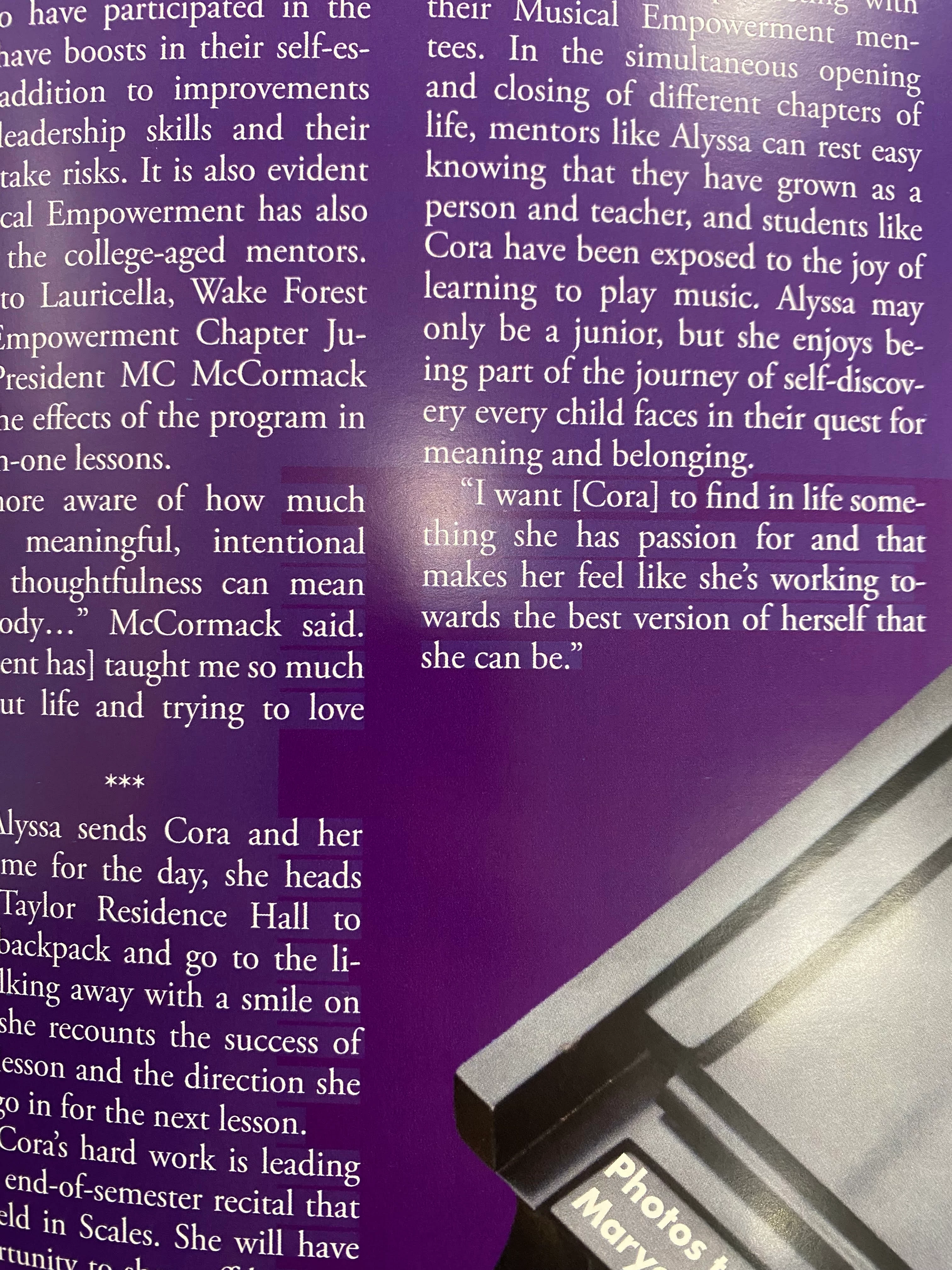

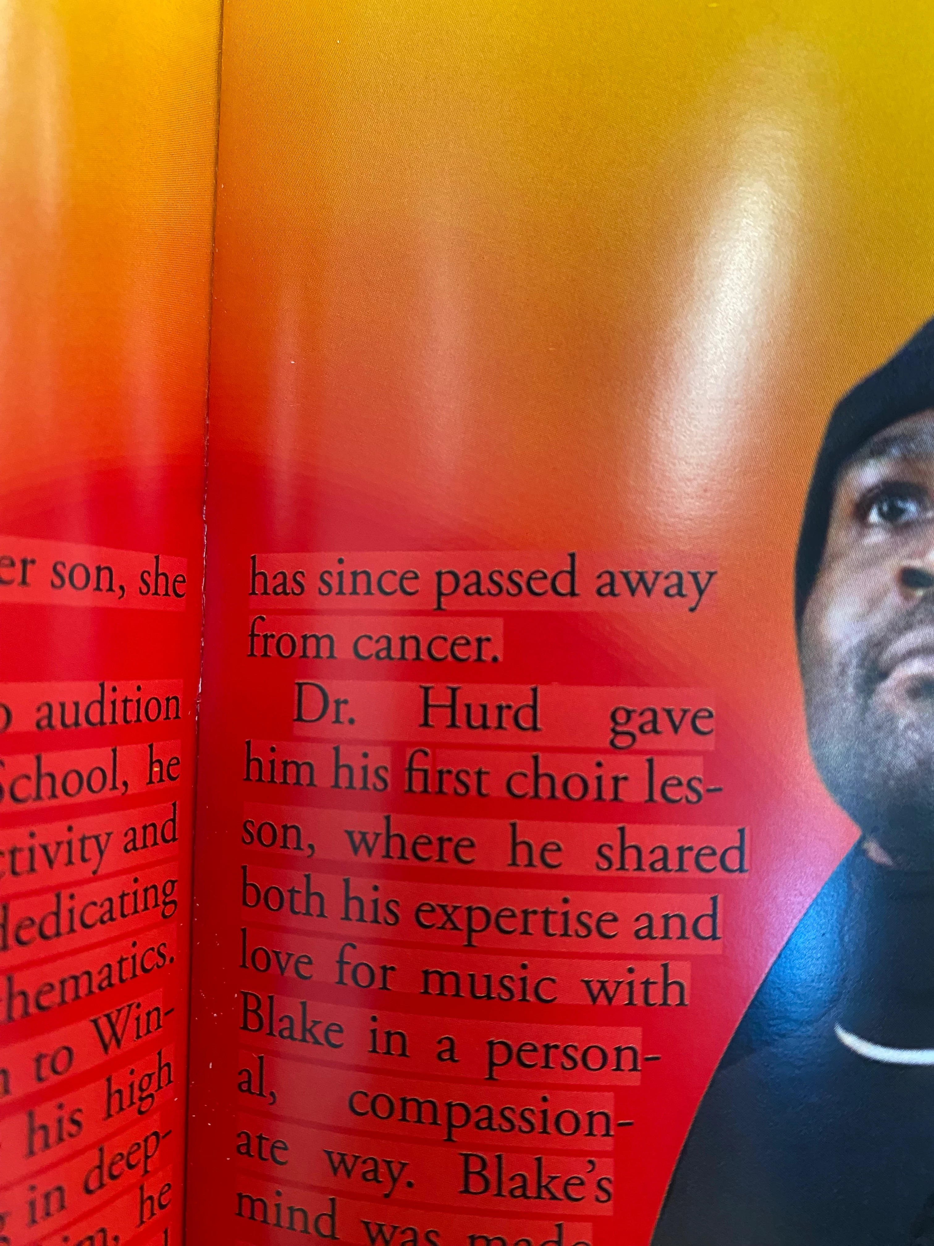

Our magazine had a print issue and I am trying to figure out what went wrong--I was not involved in this issue and I want to prevent this problem from arising again.
The attached images show the background color of the page does not match when there are objects or text in front of it. The "background" of the text/objects should be transparent, so there should be no color difference.  Keep in mind, there is no highlight on the text, and the issue does not show up in the PDFs--only in print.
Can anyone help figure out what went wrong? What issue is this?

This appears to be a flattening issue. Whether your PDF was exported properly or not, we don't know what the printer's workflow did with it. And it appears that each flattened object is having a different color management policy applied.
Was a proof provided? If the proof was okay and was signed off on, then it's the printer's problem.

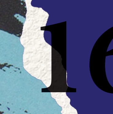

Oct 16, 2024 8:34 PM UTC
But with those view settings, there are some idiosyncracies, like this number having a transparency effect which does not show up at all in print.

Do the imported images have any transparency effects applied in their original programs? This kind of background interference is not uncommon with silhouetted objects containing transparency such as a drop shadow and will often show up in PDFs as well as in print. I am guessing that the PDFs that were correct for you had their standard set as PDF/X-4:2010 in the Export Adobe PDF dialog window. This type of PDF is the best when transparency is involved. I would suggest in the future that you have your printer use these PDFs in their printing process rather than printing directly out of InDesign.
