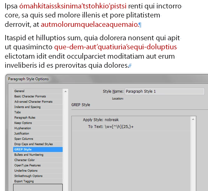

    Imo, better approach is include this regex as a part of ParaStyle definition, then it works as expected:
    Pros: you can easily manage it at any stage of your work (edit, temporarily disable, etc.).
    If you still want to use F/C dialog, just add carriage return to exclusion:
    \w+[^\h\r]{25,}+
