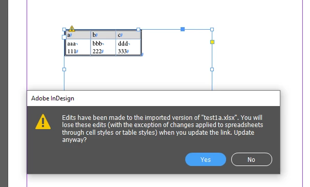

Depends on the layout - you could set an option in the preferences and link your Excel files when placing.
But every time Excel file will change - you'll lose any formatting done in InDesign.

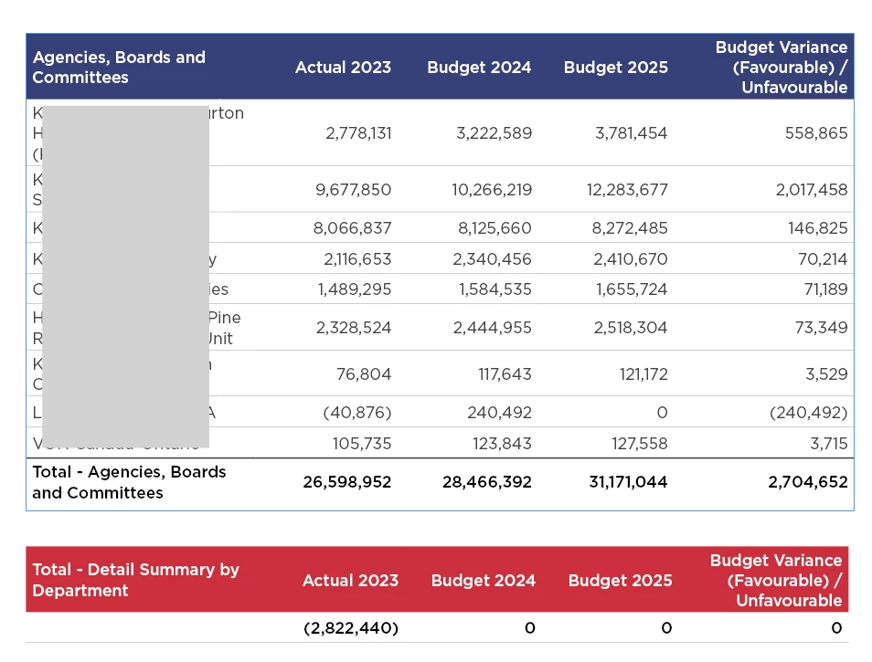

Thanks so much Robert. This is what a typical table is (this is from my InDesign file).
Because it needs to be exported into an accessible pdf, each table has to have it's own table (not subheadings...etc.)
Re: losing the formatting: So they would need to format in Excel (blue heading background..etc.) so I didn't have to update each time? The book is over 300 pages and is a mix of tables, images, text and graphics.

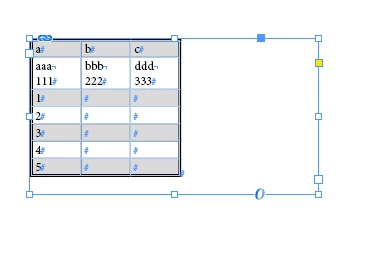

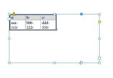

As long as those are a "simple" tables - that can be styled using Table and Cell Styles - and of course ParaStyles - you can create a TableStyle - and select it during Placing.
Then, whenever you will update the link to the Excel file - InDesign will re-apply this TableStyle:
