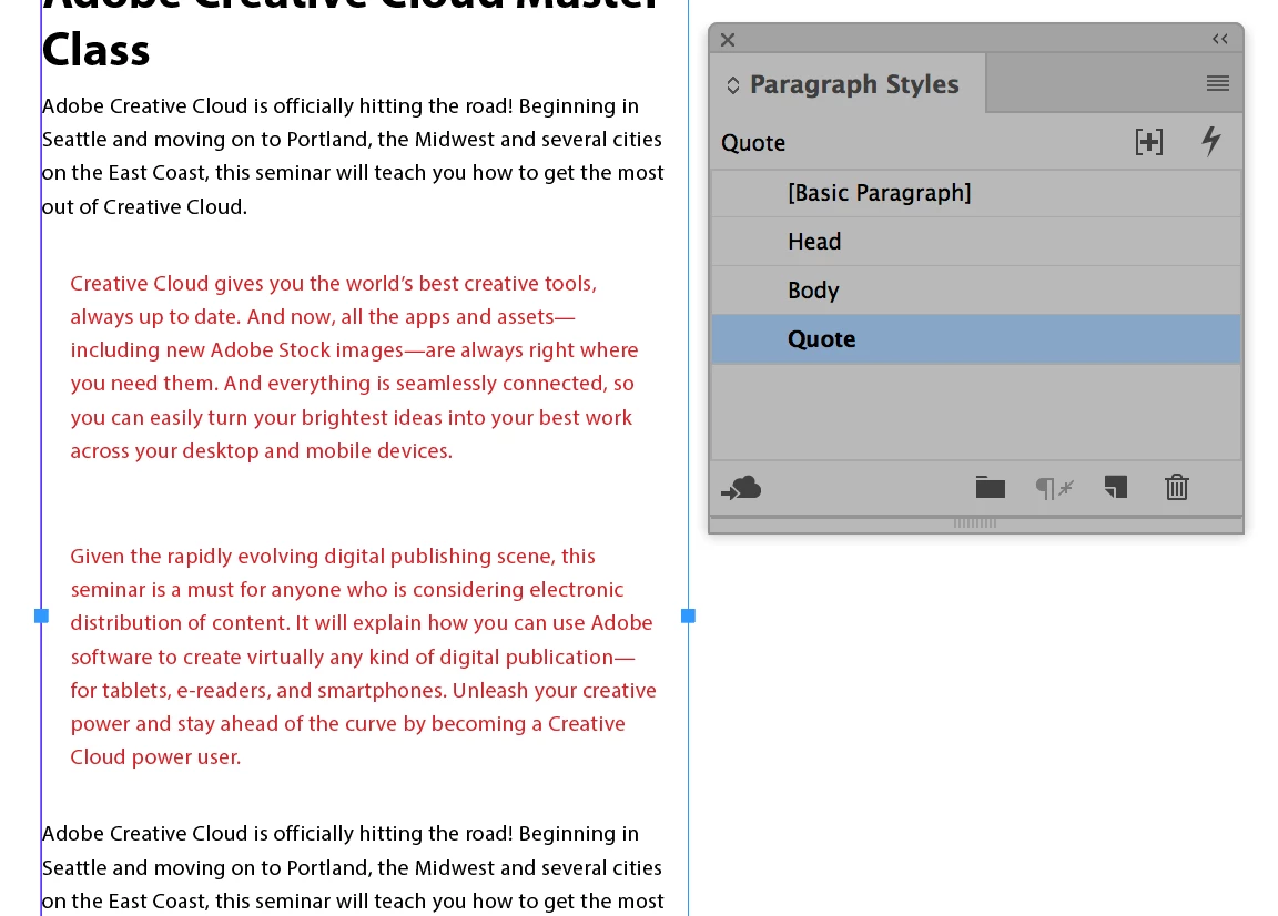

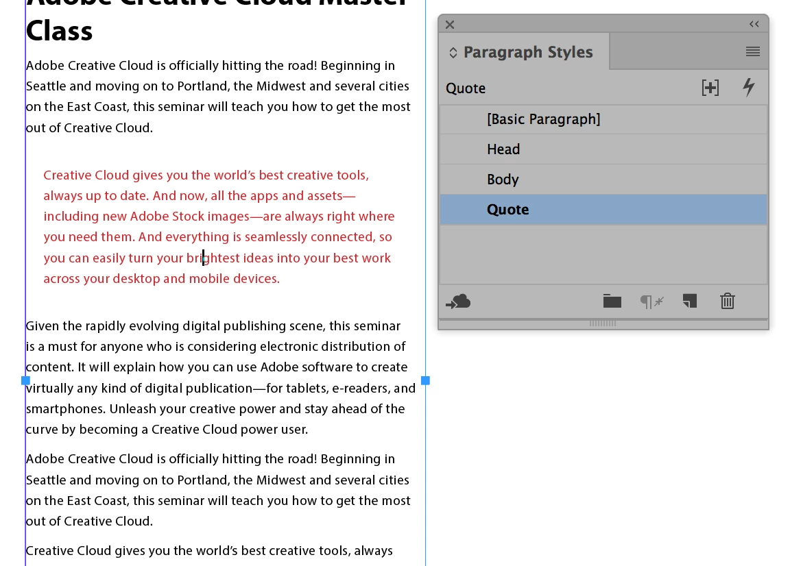

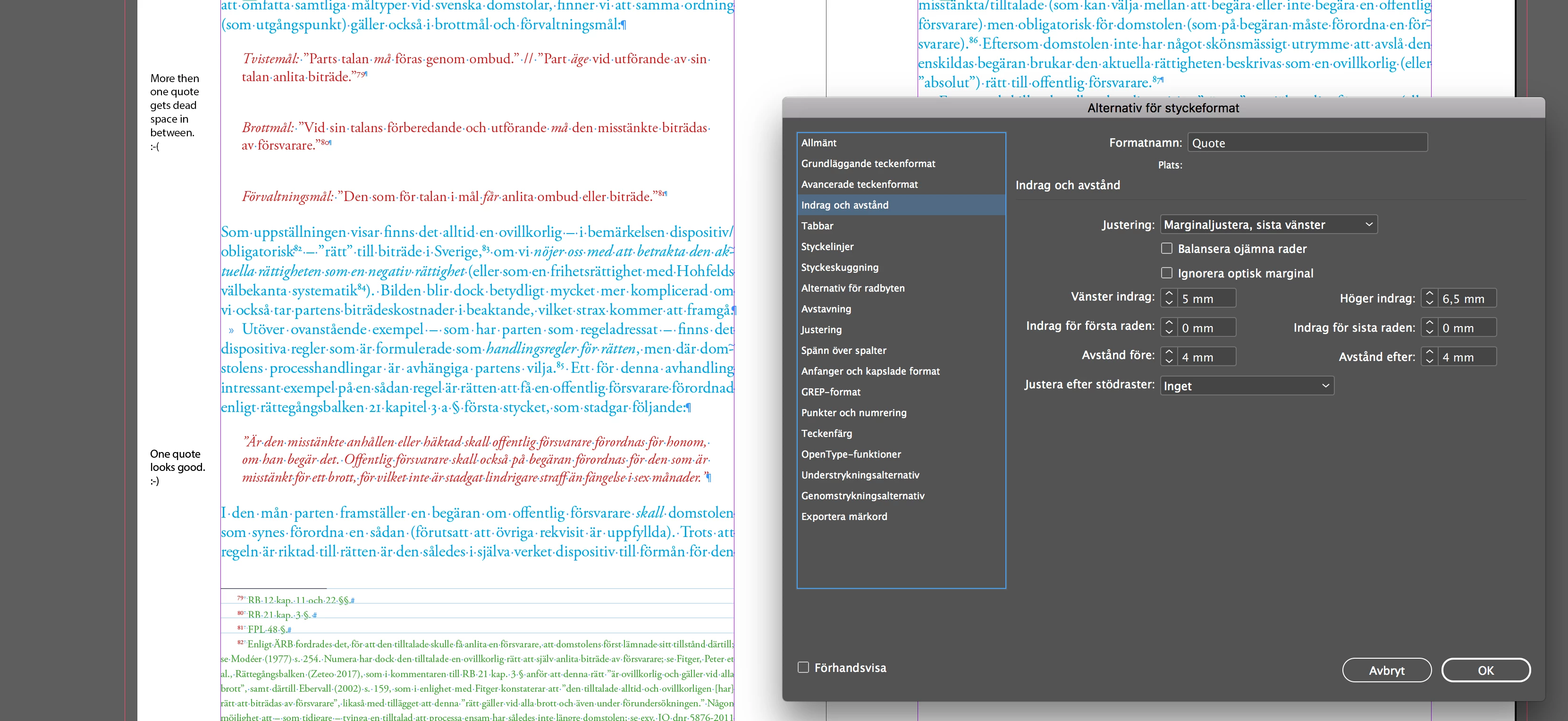

Okay, so I have made a paragraph style called "Quotes" (the red text) that I have put spacing before and after. It works when there is only one quote in the "Main copy" (the cyan text). But when there is two quotes following each other I get to much space between the paragraphs (see attached screenshot). Whats the best practice to get rid of that space and do it correctly?

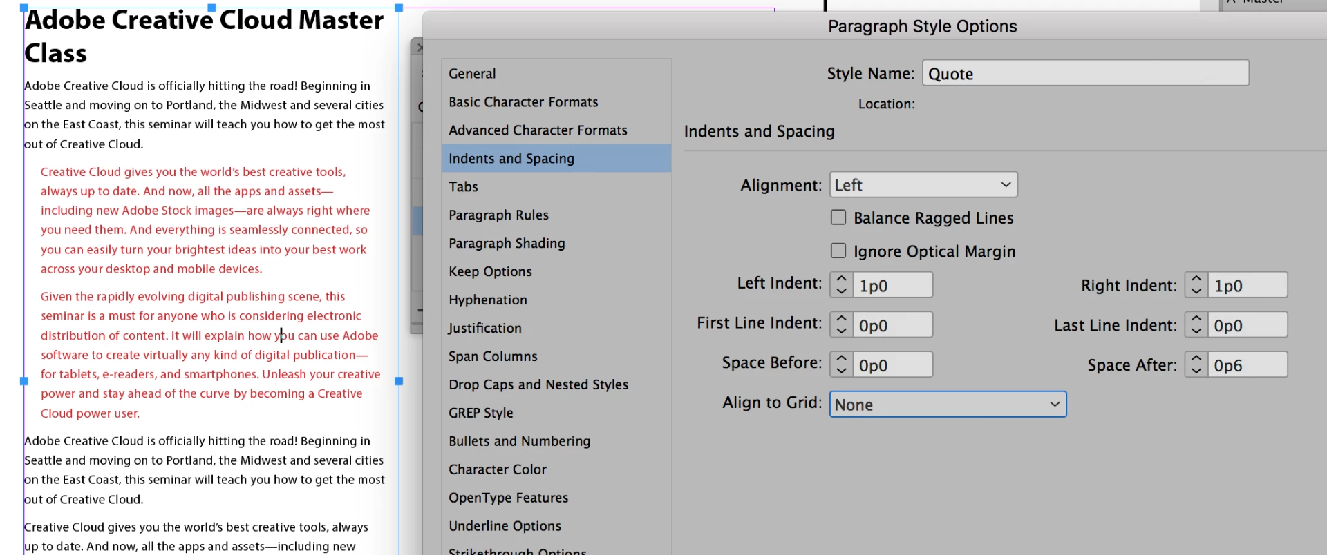

    Or there's a trick for a one column format:
    Currently what I think is going on... Good spacing for one quote, too much for two:
    So, minimize the spacing on the Indents and Spacing and then...
    Designate the quote as a Span which allows you to set the space above and below separately. It's not "meant" for this, but works perfectly for a 1-column document.
    Give it a shot.
    Give it a shot.

    It works perfect in my test document, THANKS! But as soon as i try to implement it in the real document (1200 pages with 4300 footnotes) Indesign crashes :-(. Do you have any tips for it to prevent the crash or anyway to decrease the file?
