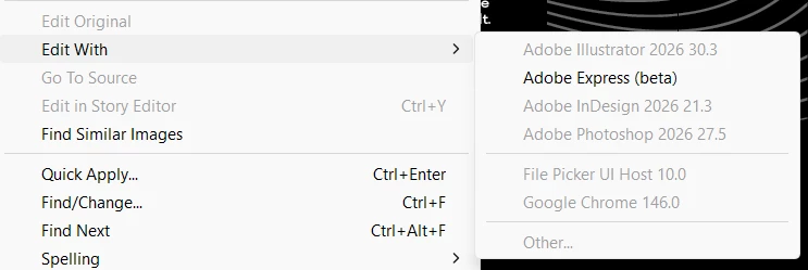

I’m using InDesign to create a magazine. I’d like to remove the background for some of the photos I’ve placed. Usually I would use:
Edit > Edit with… > Photoshop
However, ‘Photoshop’ isn’t popping up as an option. Instead, Adobe Express Beta is the only usable option. As such, I tried using Adobe Express’s new Beta feature to remove the background.
It does a great job-- however, once you hit ‘APPLY’, it seems to automatically save the photo as a .jpg without giving you the option to save it as any other file type (that I can find, anyway). This makes the whole thing a bit pointless, as the background is just white instead of transparent due to the file type.
For context, the pages are black. A white box for a background is worse than if I just left the normal background.
I might just be unfamiliar with the new feature, but is there any way to save those images as a .png instead of the automatic .jpg? It would be really convenient if not for this hiccup. I can still use Photoshop, it will just take longer.
Thanks!
    While I’m not sure why Photoshop isn’t there, you can use the ‘Other’ menu and select Photoshop. I think Photoshop then should appear in the list (as you may know anyway).
    (I don’t have an answer regarding your Adobe Express issue).
    ahpatchett
    Apr 9, 2026 3:15 AM UTC
    I might have worked it out! (Photoshop, not Adobe Express Beta unfortunately)
    I had all my images embedded, rather than linked. So I can’t use Photoshop, but Adobe Express is still an option since it’s still working within InDesign? We circle back to: could be really useful, if not for the exported image being .jpg haha.
    There were a few times where I would try to use ‘Edit With...’ and the only thing on the menu would be Adobe Express, without even listing other options greyed out. But that might just be an integration issue since it’s a beta feature, only happened once or twice.
    I’m also semi new to InDesign, I’ve been working with it for about a year :] So there’s some trial and error on my end too. For now I’ll have to re-link my photos if I want to use the Photoshop feature, and then just remember to embed them again before sending it for print.
    ...Or hopefully figure out the Adobe Express thing.

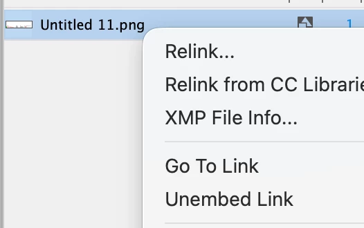

    leo.r
    Apr 9, 2026 3:19 AM UTC
    You can unembed links from the Links panel:
