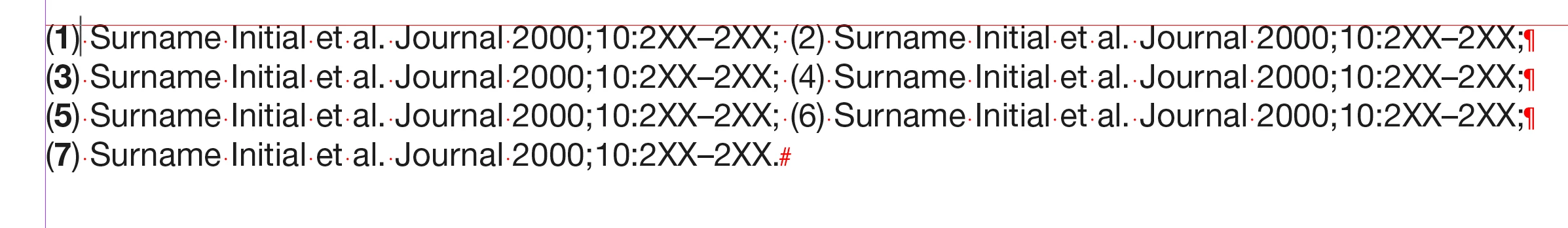

I need to be able to make just the first number within the parentheses bold, but not any others. In this sample, I have the solution:
(1) Surname Initial et al. Journal 2000;10:2XX–2XX; (2) Surname Initial et al. Journal 2000;10:2XX–2XX;
(3) Surname Initial et al. Journal 2000;10:2XX–2XX; (4) Surname Initial et al. Journal 2000;10:2XX–2XX;
(5) Surname Initial et al. Journal 2000;10:2XX–2XX; (6) Surname Initial et al. Journal 2000;10:2XX–2XX;
(7) Surname Initial et al. Journal 2000;10:2XX–2XX.

Jun 9, 2025 1:27 PM UTC
Thanks, but the nested style route just doesn't cut it where there are as many variables as these bibliographies have - the references can go well beyond a single digit and there can be other parenthetical numbers within the reference.
I now have a working GREP (thanks to people much smarter than me!) should anyone else need it:
(?<=^\()\d+(?=\))   and  (?<=;\s\()\d+(?=\))
(Needs 2 styles applied so it won’t catch any extra parenthetical numbers)

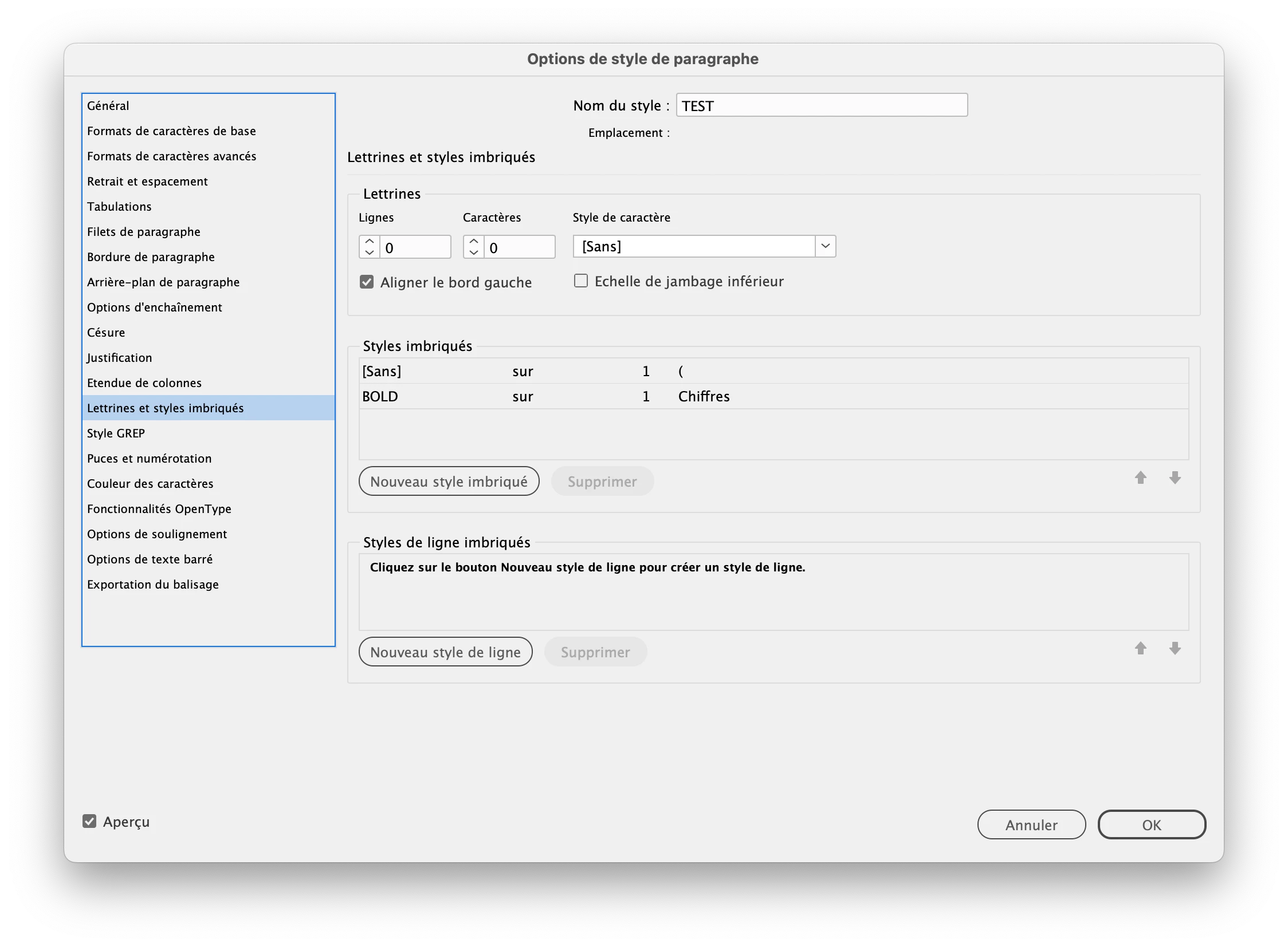

Jun 9, 2025 12:50 PM UTC
Just continue the Nested Styles beyond Jean Marc's suggestion:
add some more nested styles:
[None] through (
[Bold] through 1 Digits

jmlevy
Jun 6, 2025 3:44 PM UTC
Just to be sure: is there a hard return at the end of each line?
If yes, it means that each line is a single paragraph, so a simple nested style will work.
Jun 9, 2025 8:18 AM UTC
No, there isn't a hard return at each line (apologies if my copy/paste added those instead of soft returns), and the nested style doesn't capture the (2), (4) or (6) in this sample, so it does need to be a GREP
