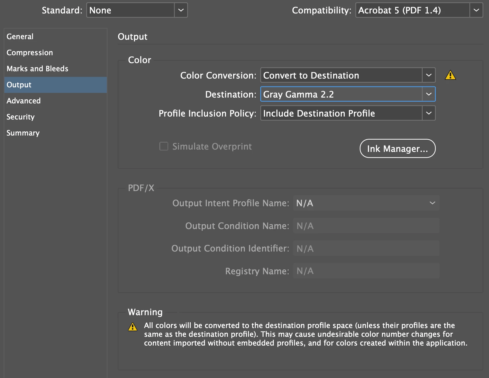

    Hi nik,
    As noted above - here is what I ended up using:

    Hi ​@turner111, I’m a little confused by your message.
    Did you mean that this was the setting you used when you noticed the color change, or that this setting helped fix the issue?
    If it’s the latter, try selecting Preserve Color from the Color Conversion drop-down menu.

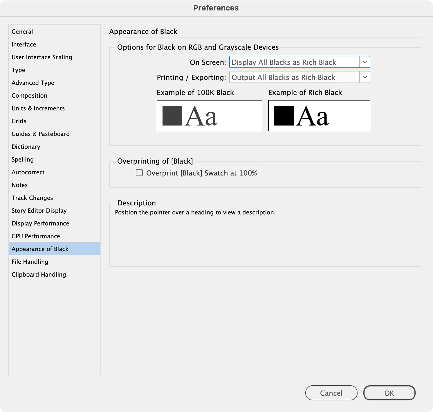

    Did you set both your On Screen and Printing/Exporting Appearance of Black to All Blacks as Rich Black before you export?
    Also, Is the problem in the PDF’s display, or the actual print output? Printing inks are somewhat transparent, so the appearance of 100% Back only would almost always be less black than Black + CMY.
