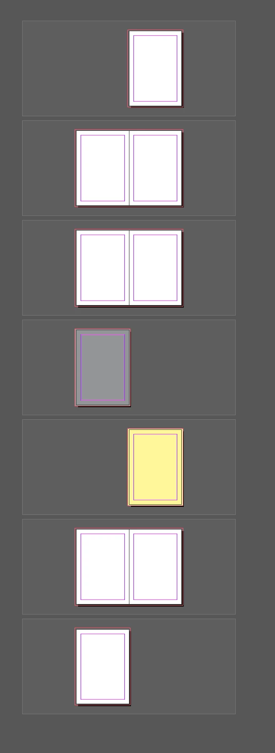

Correct answer Willi Adelberger
Your example shows exactly what it does when you use bleed in the inside.
You should NEVER convert a facing page document to a single page document to accomplish what you want as you get a mess with styles relative to the spine.
If you mean that an image should extend into the blee or not be seen on the oopposite page you have to setup your doument differently:
1. It is ok and total correct to set up this document with facing pages.
2. On spreads where a design break is between pages (like different backgound image or color) you have to separate the 2 pages into 2 spreads:
  1. Select the spread in the page panel by clicking twice on the page numbers in the panel.
  2. In the page menu deselect allow shuffle pages.
  3. Select the right page by cllicking twice on its thumbnail
  4. Drag the page aside as a beam appears release the page.
Now wou have for each page a spread. Extend the bleed to the bleed border.
In the image you see, how it should like.

Willi Adelberger
Willi AdelbergerCommunity ExpertCorrect answer
November 12, 2019
