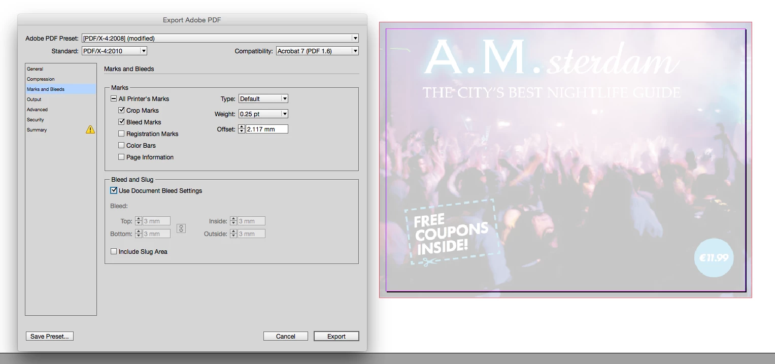

    Looks like you first page art doesn't cross into the inside (left) bleed area. It should be something like this where the document includes inside bleeds and on export I'm checking Use Document Bleed Settings and including both Bleed and Crop marks:

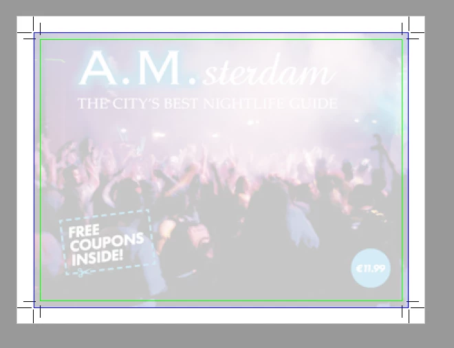

    In Acrobat:

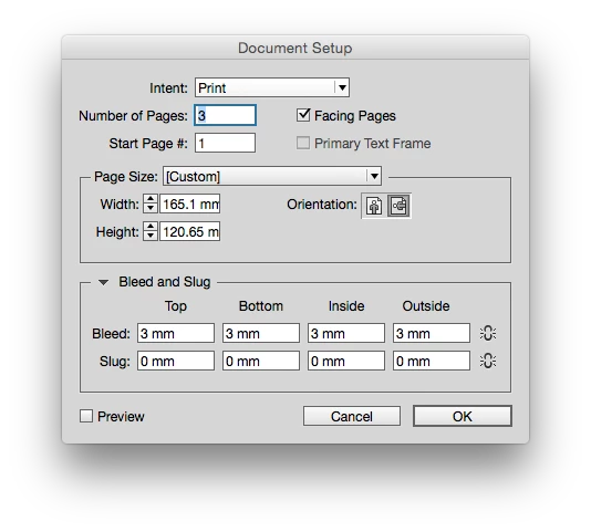

    I'm presuming this is a saddle stitched booklet. They probably don't actually need the bleed on the spine/inside, as there will be a fold there rather than a trim. If your ID document is set up as spreads, set your bleed to 3mm on all edges except the inside, and then do as Derek advised.

    When you use the InDesign Acrobat PDF Presets, select Pages (not Spreads) and under the Marks and Bleeds tab select "Use Document Bleed Settings".
