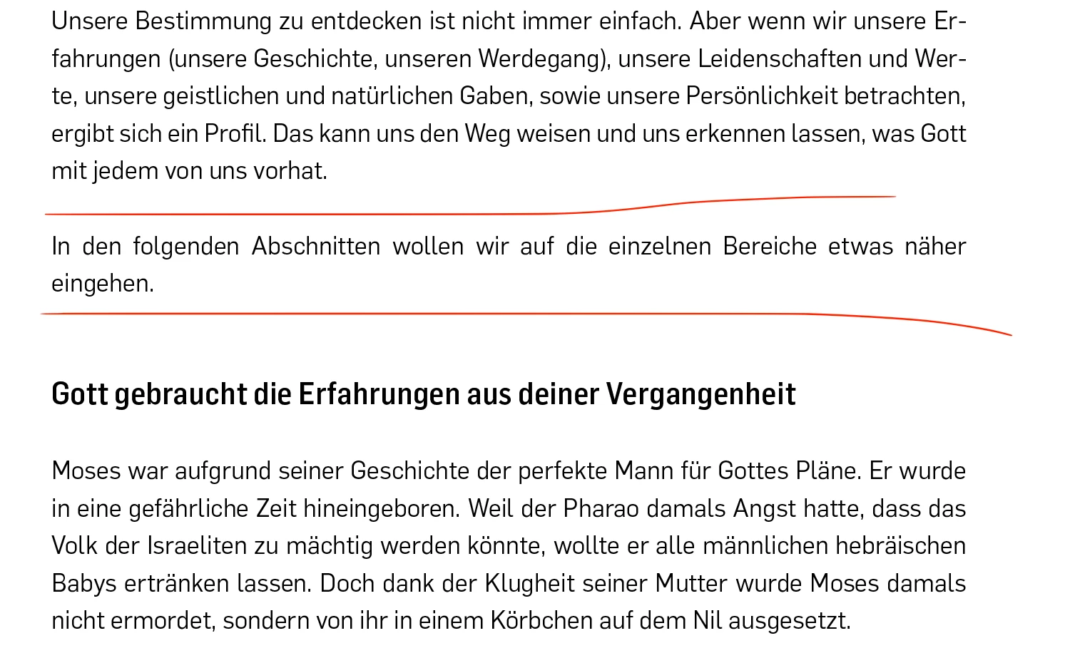

I am working on my first book layout. For the body spacing, it seems that sometimes the spacing between words is larger in certain places. I imagine this is happening because the body text is set to justify with the last line aligned left.
My question is: Is it acceptable to leave it like this? If not
, what solutions are there to fix this?
Thank you very much!

  1. With the justify setting InDesign is forced to make the space between the words larger. Specially if the last word is not allowed to hyphenate.
  2. You can change the justify settings in the paragraph settings (fine tuning) to allow a spacing between glyphs (what I recommend for those short paragraphs).
  3. Another influence is the language. Did you set up your paragraph correcly with German 2006?
For which publisher do you set up? I do a lot for Logos Editions, E21, and many other Christian Evangelical Publishers in Germany and Austria.

Thank you! What are some common justification settings? Are there any good standards, or does it vary based on projects? I'm not very experienced in this area, so I don't want to mess up the text. The language is set to Swiss German 2006 (it's for a Swiss-based company).

@Willi AdelbergerAlso, when fine-tuning the text, is this something that should be done as soon as it's noticed or at the end?
That's up to your customer. I would hyphenate eingehen but there are people who object to breaking such a paragraph. Another option would be to play with word and letter spacing (in the Justification window), maybe that will take eingeben back a line, but that probably means that the paragraph will be too tight.

Are you referring to the horizontal space between words, or the vertical space between lines, indicated by the red lines in your screen shot?
The former are controlled by the justification settings (and your choicwe of alignement is a factor), the latter could be caused by several different things.
Look for empty paragraphs, a space before or space after setting applied to the the paragraphs on either side of the gap (coul;d be part of the paragraph style or a local override), or an Align to Grid setting on the paragraph after the gap (my suspicion for waht is causing this). Again, this could be part of the style or a local override.
Bawseline grid alignement is a useful methos for keeping lines of text aligned across columns or pages, but it only works when the base line grid is set to the correct spacing, generally the same as the leading of the body text.

I am referring to the spacing between words like this:

Those spaces are controlled by the values set under Justification in the paragraph style assigned and will shrink and grow to fill the line in fully justiufed text, as you are using, with inDesign occasionally having to violate the limits when some other condition in the text occurs, such as trying to fully justify a line with too few words. You can turn on a warning highlight for this in the preferences under the Composition setting.
As to whter this varialbility is acceptable, it is a necessity when using fully justified text.  If you are not happy withthe amount of variability in general, you should try changing the minimum and/or maximum allowances in the Justifcation settings, but be aware that doing so will cause all of ther text in your document to reflow.
You could also do this for single paragraph in isolted places, or use the (to my knowledge undocumented) keyboard shorcuts Ctrl + Alt + Backspace (Cmd + Opt + Backspace on Mac)  and Ctrl + Alt + \ (Cmd + Opt + \)to tighten, or loosen, respectively,  word spaces in selected text. I used to use those all the time to eliminate runts and orphans in newspaper columns, or to adjust the number of total lines to fill an allotted space, and occasioanlly in books, particularly in text next to an image whre text wrap has been applied to get a more pleasing flow, but they must be used judiciously.
