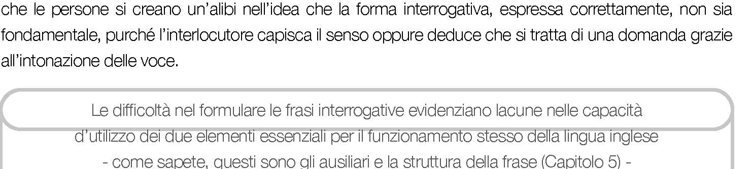

Hello there,
Just wondering if anyone knows why the borders I am placing around short paragraphs of text show up double as in the example below (where bordered paragraph, starting below a normal paragraph,  wraps itself around the first lin of text). Borders only show up wrong after I go back to pages to review my document in normal or preview mode. When I am actually type-setting a page, any borders appear as they should.
I don't know what to do. Boo hoo! Help!?
Kirsten

January 23, 2024
I also struggle with this exact issue, but in my case, the formatting is also wrong in the exported pdf.
I can solve the bug by closing and opening the document and then exporting - but with large documents, thats quite a nuisance (and if i forget one time to save all the files, open them again and then export the pdf, the pdf is incorrect).
Also, if I happen to change a minor thing (like, correcting a letter or change the position of a margin-textbox) the borders are incorrect again  (and I have to go through the whole "save the file, open the file, then export" process once more 😕😕
Is there a better solution to work with paragraph borders and not having this issue?

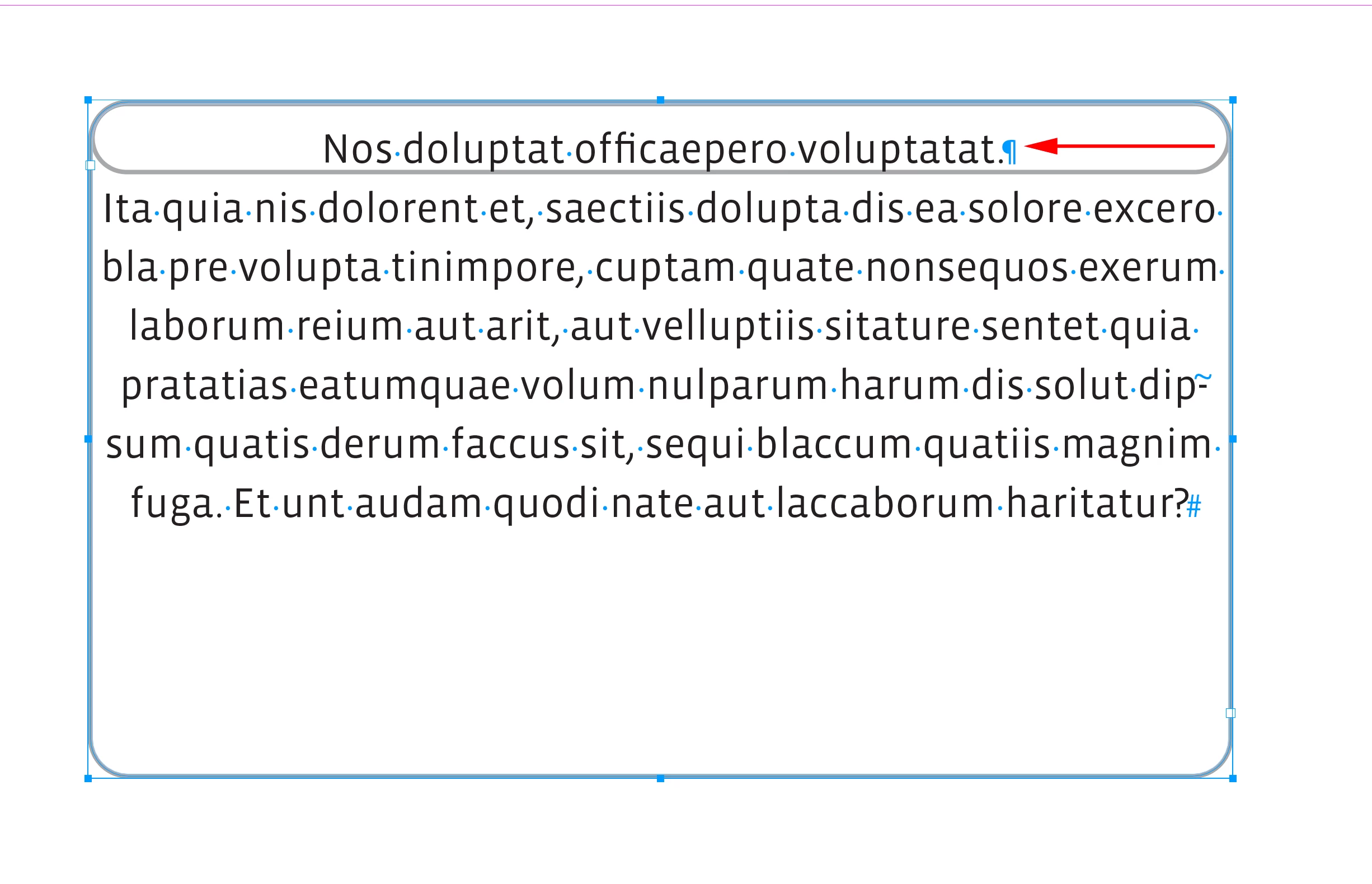

rob day
March 8, 2022
Can you show Hidden Characters? I can replicate your capture by applying a Stroke to the Text Frame and turning on Paragraph Borders for the first paragraph:
March 8, 2022
I just returned to my book file document to screenshoot with hidden characters showing and to my delight have found that bordered paras are showing properly throughout. No idea why! I've checked another book file document, and bordered paragraphs are showing properly in there, too.
Yes, I have seen how if I return at the end of a line of text inside a bordered paragraph, the border completes itself - much like in the example you've sent. Thank you. The text alignment also goes beserk.  So, I control return to avoid that.
If the problem ever comes back, never say never!, I'll be sure to post a screenshot showing hidden characters.
Thank you for the reply!
K
James Gifford—NitroPress
March 8, 2022
Borders can be glitchy when developing a layout; sometimes you have to fully refresh a page (by using Alt+0 to force full-screen zoom, etc.) to get these display glitches to go away.
But yes, having any kind of break between paragraphs will make ID put a border around each. Besides the above technique of looking for hidden charactes or just using Delete-Space to try and erase them, you can get borders to merge by being sure the "Merge Consecutive Borders" box is checked in the Paragraph Border menu. (I frequently use start/middle/end bordered paragraphs to control spacing and layout, and this checkbox makes sure they form a continuous border. But it also sometimes glitches as I edit; see first paragraph above!)
