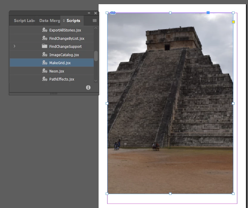

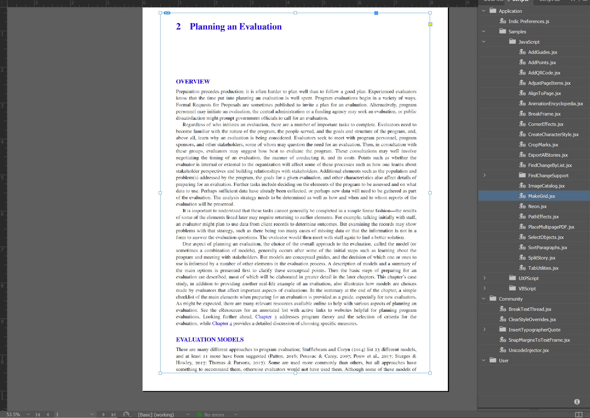

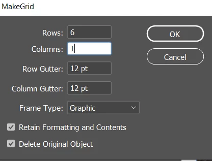

Place your image at the size you want
In the scripts panel there's a make grid script

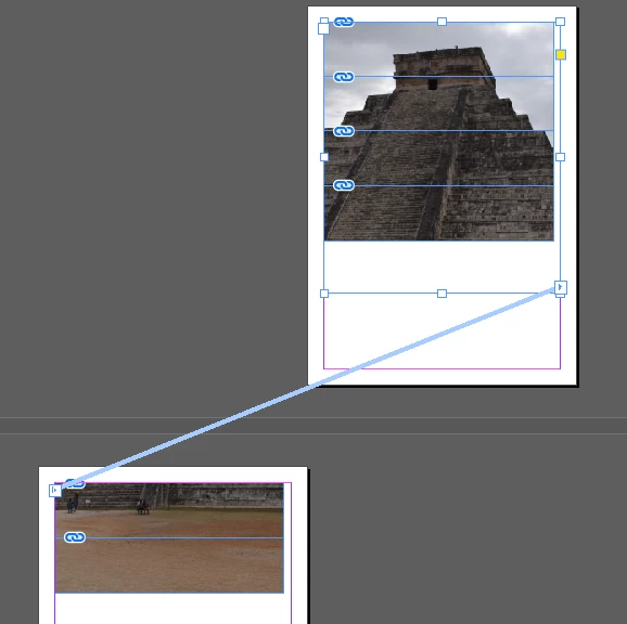

You can then cut and paste each section into a text frame
Adjust the line spacing so there's no gaps
Then your image will flow from page to page
Sample file attached.
