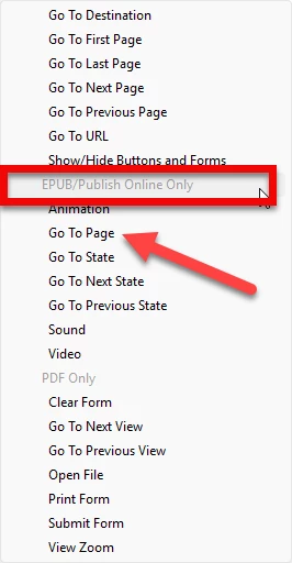

Stop using buttons in PDFs and use simple hyperlinks or bookmarks. Buttons are very unreliable and won't work in most third-party PDF reader or mobile devices.
Also, please note that "go to page" action is not supported in PDF. It's an EPUB or Publish Online function.

BobLevine
BobLevineCommunity ExpertCorrect answer
Jan 13, 2026 4:28 PM UTC

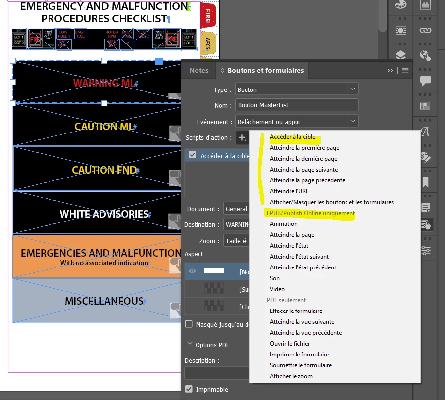

Anick5C60Author
Jan 13, 2026 6:45 PM UTC
Hi Bob,
I'm using Go to Destination
Anick5C60Author
Jan 13, 2026 6:59 PM UTC
@BobLevine My fault, I'm using Go to destination, see the Sreenshots in the preceded post.
