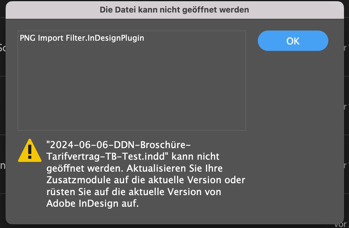

Das Problem trat spontan in Indesign 2024 (19.4) auf. Neuinstallation hilft nicht. Jemand eine Idee, wie ich die Datei retten kann?

seems like a corrupted indd file (2024) could not open without this. but i cant find any hint where to get it or where to install it.
June 28, 2024
Reinstalling rarely fixes everything - you can do a complete reinstall using the
Creative Cloud Cleaner Tool https://helpx.adobe.com/creative-cloud/kb/cc-cleaner-tool-installation-problems.html
By @agenturimturm
Try to export the file to IDML, then open. Normally, it should remove external plugin dependencies. (Unless this error is a new bug similar to the one that caused problems between InDesign 19.2 and 19.3 versions.) Anyway, try IDML and see if it solves the issue.
June 28, 2024
the problem occurs when i try to open the indesign file. so no way to export to idml.
i tryed https://ixsavebackgenerator.de/idsb/web/service/index_en.jsp for converting indd to idml online, but this does not work either – because the file is corrupted.

Did you embed the PNG file or did you link it as external asset? Embedding is the main cause of corrupted file.
Why do you use PNG? I recommend always never to use it in InDesign as itcauses often problems. If it has transparency, use PSD.

From your screenshot it looks you are Opening instead of Placing the png file...
June 28, 2024
yes, the problem occurs when i try to open the corrupted indesign file.
