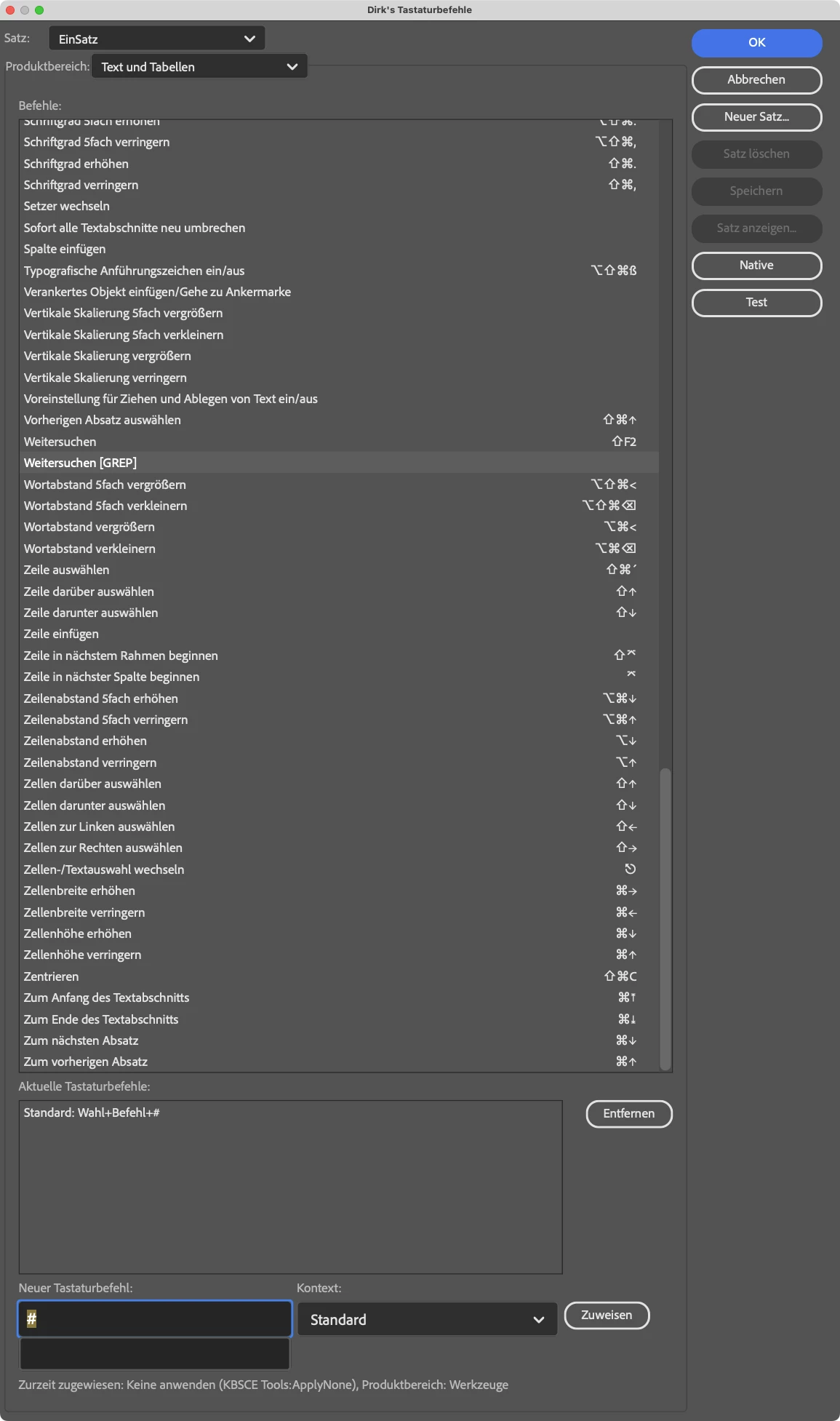

So you're still looking at shortcuts and related UI. This summer I also spent some (too much) time on them, as an exercise in UXP, initially copied the existing dialog to validate my script methods. Below is the intermediate result with a few additions. One time sink was to convert between UXP key events and virtual keys, also capture all of them. Better done in C++, UXP is far from complete. I filed several related improvement suggestions.
On the other hand have a look at Bridge or Premiere and see their reworked KBSC Editor, I guess that at some point in time this will also trickle down to InDesign rendering outside efforts obsolete, so I shifted back my focus to other projects.
