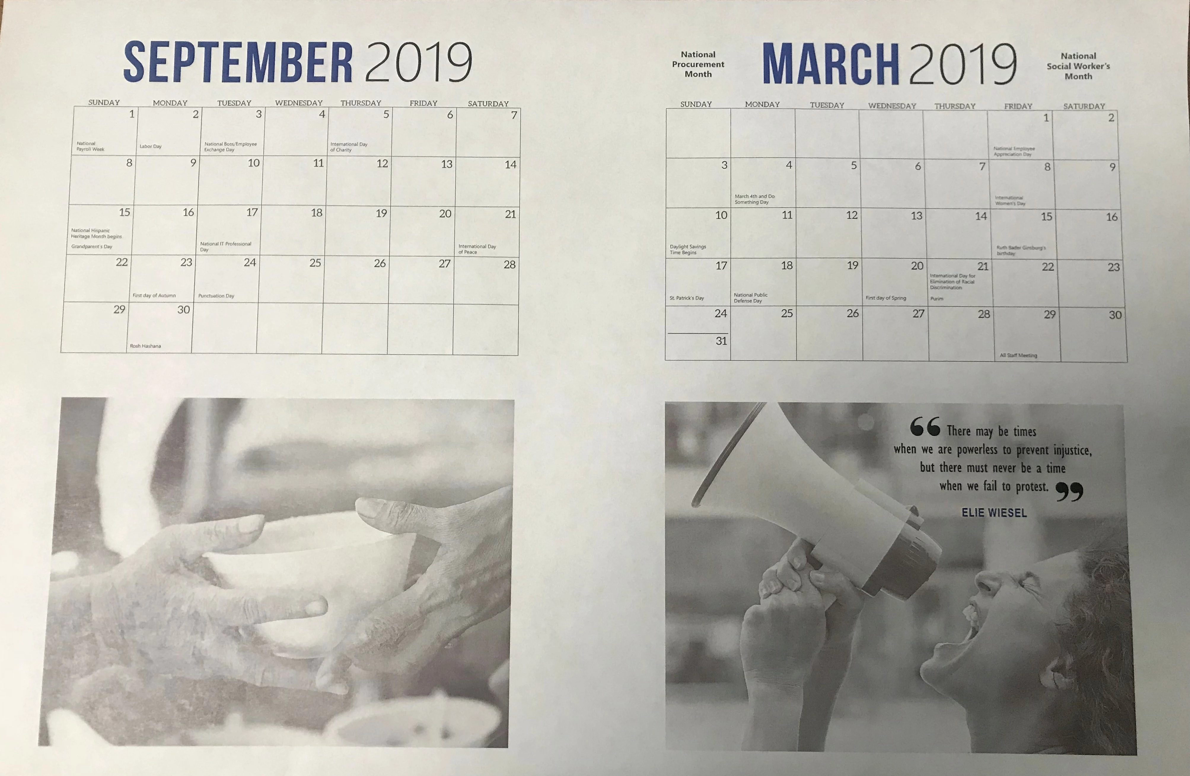

I am trying to print a wall calendar on 11 x 17 size paper with a saddle stitch. Once completed, a photo will appear at the top of a page with the corresponding monthly grid on the bottom. I have followed instructions from a similar post on the forum (from 11/2016) and another from a "Marc Anthony" website, and I STILL cannot print the calendar the way it needs to be printed. I have tried all sorts of layouts, rotating the pages, adjusting the print options, etc., and I absolutely cannot make this work. If anyone can please help me out, I would sincerely appreciate it.

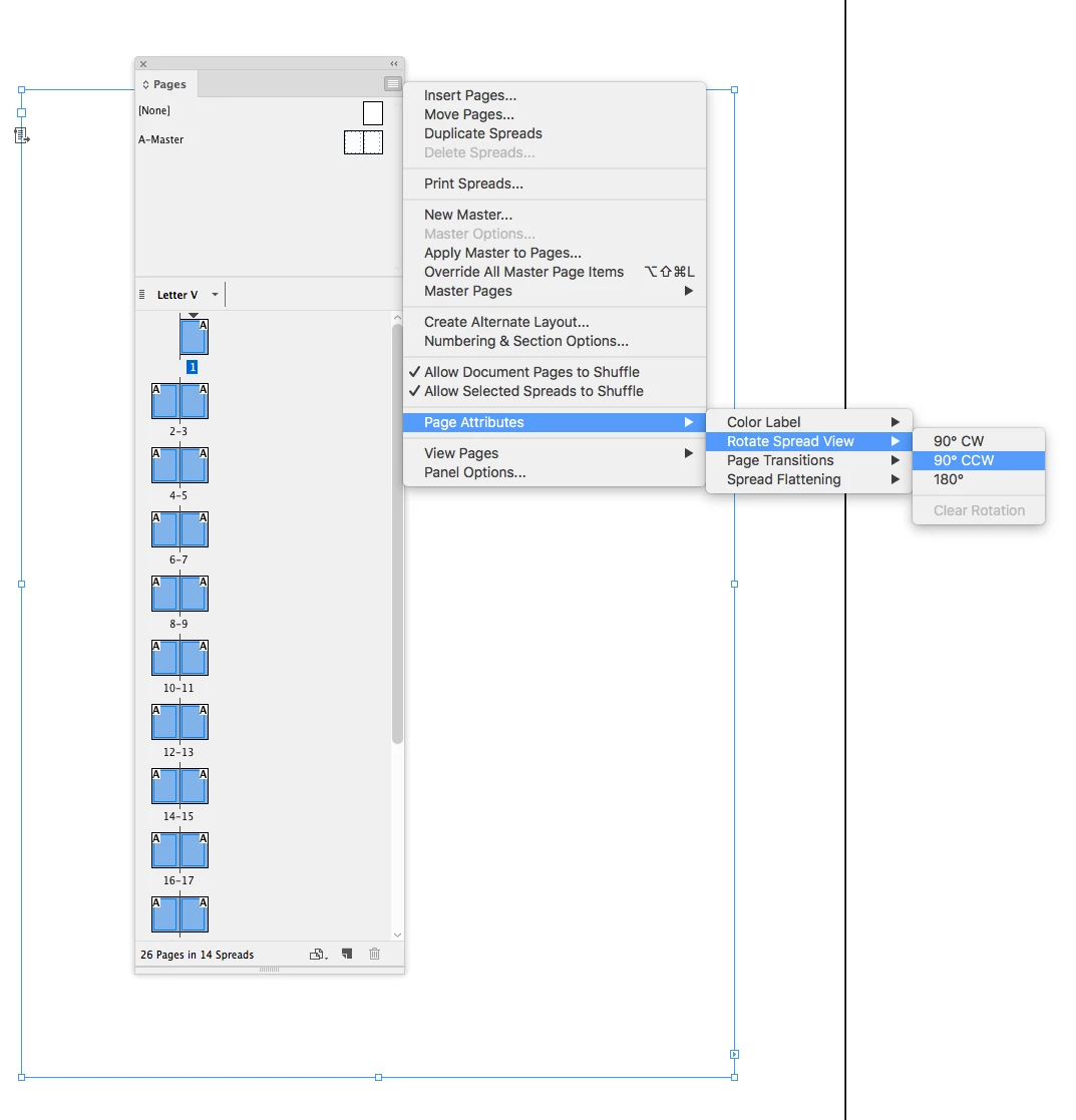

    Usually for calendar layouts you rotate the view from the Pages panel, which rotates the view but not the actual pages:

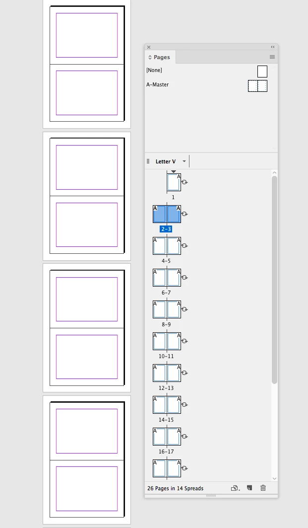

    The page layout then has the binding spine on the horizontal edge and the Pages panel shows a rotation icon.

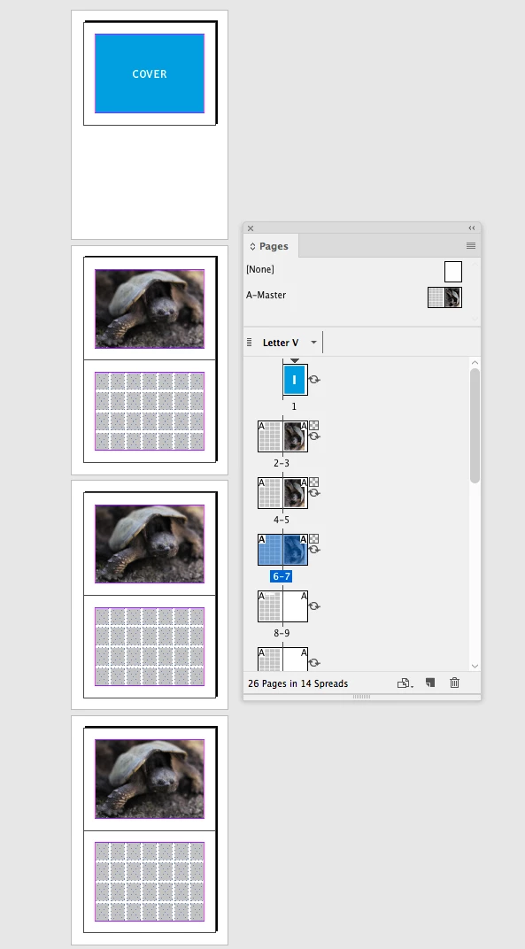

    From there you layout the pages as they should appear in calendar format, with the image on the top and the grid on the bottom. If you look at the Pages panel you can see the grid is on the left page and the photo is on the right page of the spread.

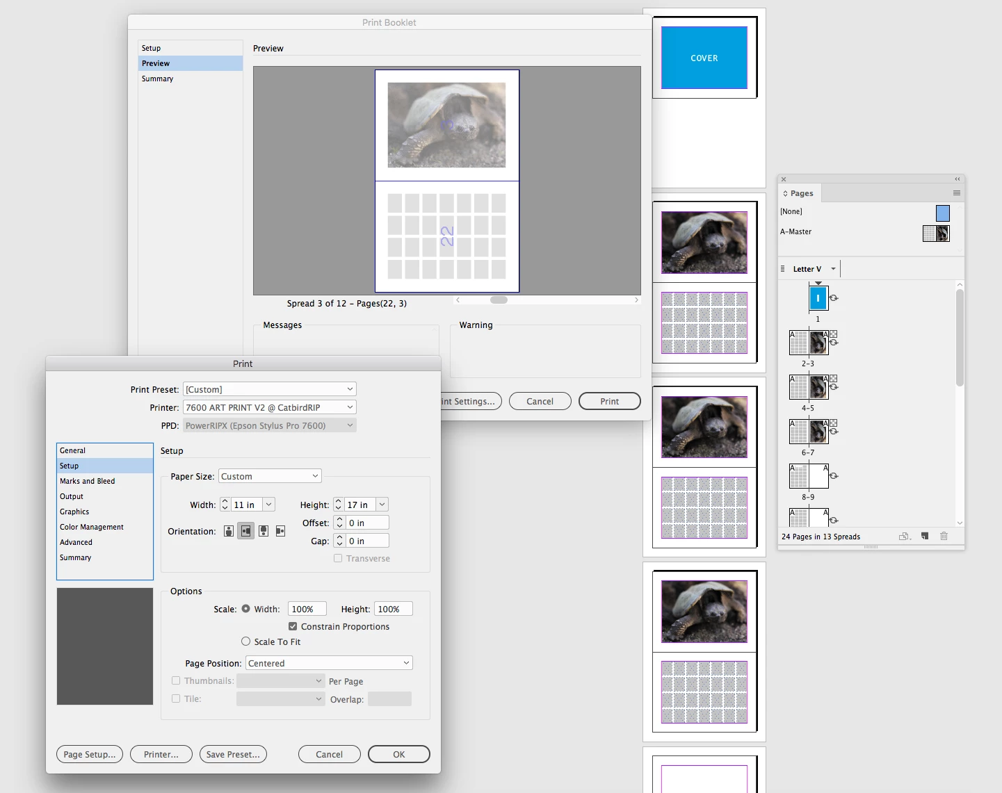

    If you a printing in house you can do the imposition with Print Booklet, but it gets a bit complicated and not all printer drivers work happily with Print Booklet.
    The page count has to be in multiples of four—you are printing 2 page spreads front and back of the sheet. Here's a 24 page saddle stitch imposition, it's important to setup the Print Booklet>Printer...>Print dialog correctly. Make sure you check Print Blank Pages under General.
    Here my Page Size is 11x17 so the Orientation has to be Landscape.

    With this particular project, bleed is not a concern. The problem seems to be in the layout (and is most likely due to operator error). My end goal is to have the calendar photos and their corresponding grids print landscape, with the 11 x 17 pages set to portrait. Mainly what seems to happen is that two graphics and their corresponding grids appear side be side (with the grid incorrectly at the top and the graphic incorrectly at the bottom), instead of one graphic landscape at the top of the page and its corresponding grid at the bottom of the page.
