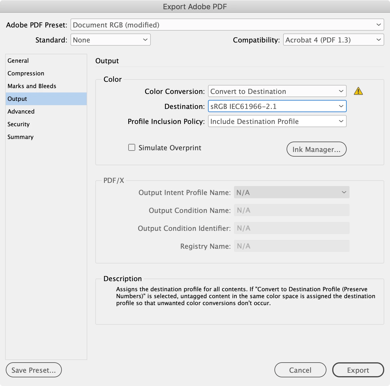

Hi @Distribuidora28659976pobv , By digital version, do you mean an Export to PDF? When you Export a PDF you can set the Output>Destination to an RGB profile and all of the document’s color will be converted to the Destination color space:

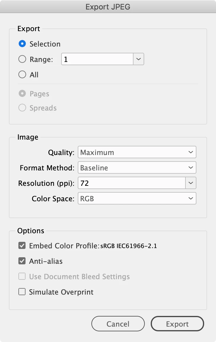

You can also do the same on an image Export (JPEG or PNG).
