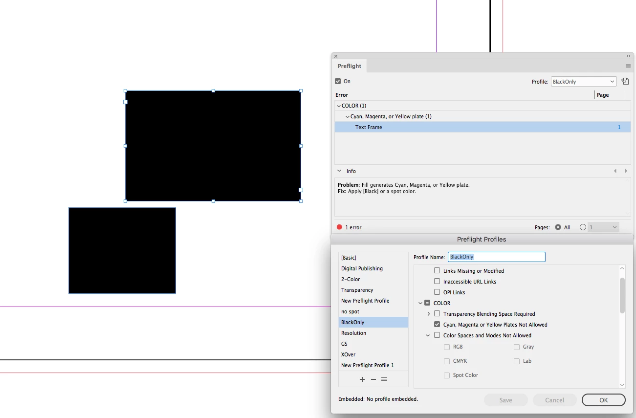

    If it's an InDesign file you can create a Preflight rule that will flag any instance of a color that uses the CMY plates. So this would catch a rectangle filled with RGB but not one filled with 0|0|0|100 CMYK. Double clicking the error selects the item

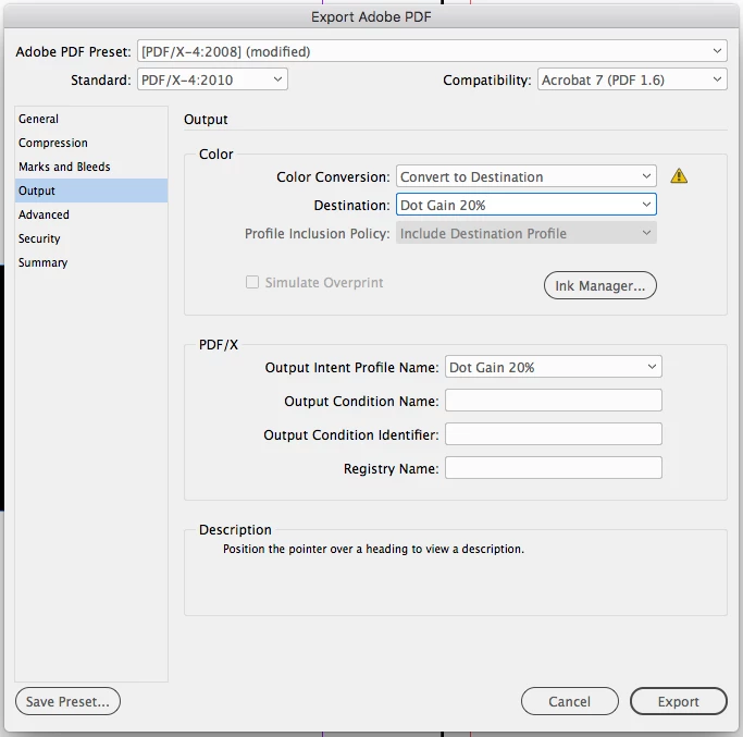

    If you are delivering a PDF, use the PDF/X-4 preset and set the Destination to a gray profile, and that will export a 1-color PDF even when there are RGB objects:
