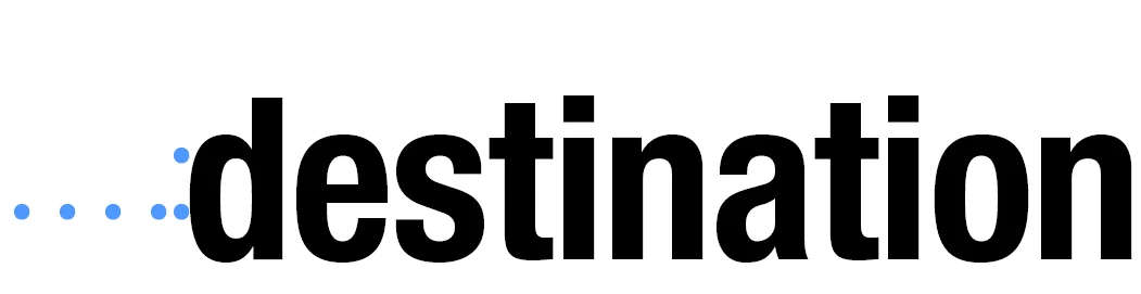

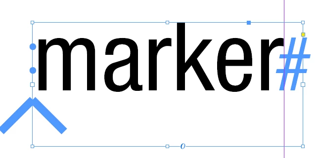

Depends on what kind of anchors you mean. I think you can search for anchors just fine with the Find/Change dialog, both in the regular Text tab as well as the GREP tab.  Use ~a to find an anchor. That's the marker for an anchored object.  ~I is an index marker. If I make an actual index marker with InDesign's Index panel, it looks like this:
and ~I will find it in the F/C dialog. I don't know how effectively you can change it with the F/C dialog, but that's how it is findable. This one, however - this marker with the invisible character that looks like a colon, which is in this case a hyperlink destination - you can't find with ~I:
That's what you're looking for, right? A text anchor can do a few different things all covered by Peter's script. A look at the source seems to indicate that he finds all of these text anchors by finding all of the possible things they can be - the script doesn't search the text for thingies, it makes lists of all of the possible hyperlink text sources, all of the possible hyperlink page sources, and, all of the possible cross-reference sources. If that's what you need to do, that's one possible solution.
From the other direction, I think you can search the text for <ffef> which is the Unicode value for the marker. Interestingly enough, you cannot search with GREP for \x{ffef} - instead you have to use the Text tab of the F/C dialog and search for <ffef>. This will find all of the index markers, hyperlink text sources, xref sources, and zero-width spaces in your document. Accordingly I would suggest that you avoid the use of Change All as a result.
