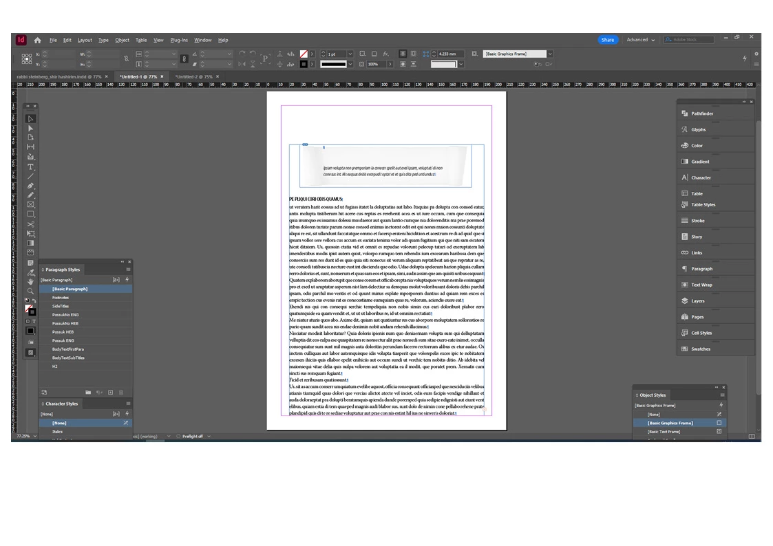

Here is a screenshot. I want the scroll graphic box to go behind the title text. It is a transparent box so it's hard to see that it is above the text, but it is above the text and making the text slightly lighter than it should be.
If I would put the graphic in a separate text frame behind the main frame and then group them together, it would not work if there would be edits to the text of the book because it would cause the text to shift.
I could possibly leave the scroll above the text since it is semi-transparent and the text would be grey rather than black. But will this cause any problems with the printing? Can a semi transparent object be placed above text?
I have in the past had problems in print when transparent objects were placed above text.

It is not possible.
Can you post a screenshot showing what you would like to achieve? Maybe someone will find a workaround.
