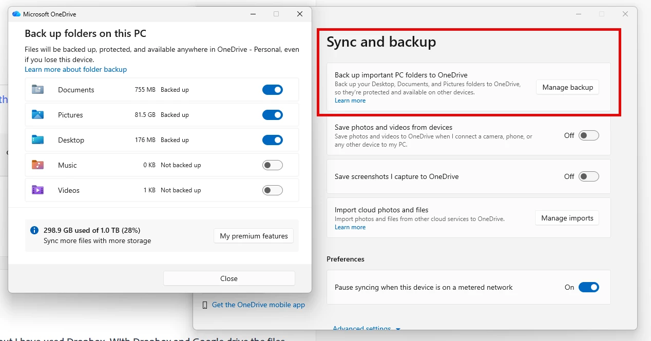

    I have found that DropBox and Box work more reliably than Google Drive; but for simple file backups and storage, Google Drive is great. OneDrive works well, but is inflexible about what folder I want to limit it to. It forces a takeover of my Desktop, Documents and Photos folders, which I don’t want it to do.

    Dive into the OneDrive settings, ​@Mike Witherell. You can manage them there:

    Yes, Bob, but it doesn’t allow you to turn off Documents, Pictures, and Desktop. It turns into a file-hostage-crisis. OneDrive effectively takes these files off your computer and keeps them on the cloud if you try to change it.
